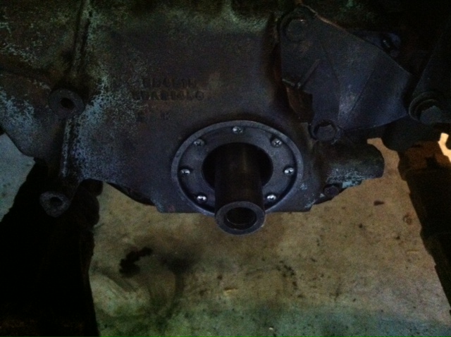

                  A 1-11/16 is a hair too small so I took a little off the bolt with my grinder and it worked perfect. Wanted to stick with a socket so I could use air to get it off and my torque wrench to put it back on.
                  I followed the link below and the instructions to drill out the rivits. While I had my front cover off I inspected the timing gears, chain and chain pads. Everything looked great, only 48K on this engine. The front main seal was hard as a rock and had a split in it. I'm suprised it wasen't leaking more then is was.

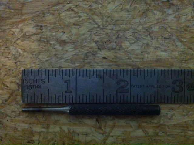

                  Attached a pic of the small punch that I used to pop out the rivits, this and a 3/32" drill bit worked perfect. I drilled down 2mm or so then a few hits on the punch and the rivit came right out. No damage to the front cover. Ran a 1/8" bit through the cover holes, it only removes a little material. Then tapped the holes 4mmx.75 and used SS phillips screws. Think they were 10mm in length.
                  Truck is back together and on the road, no leaks!!
