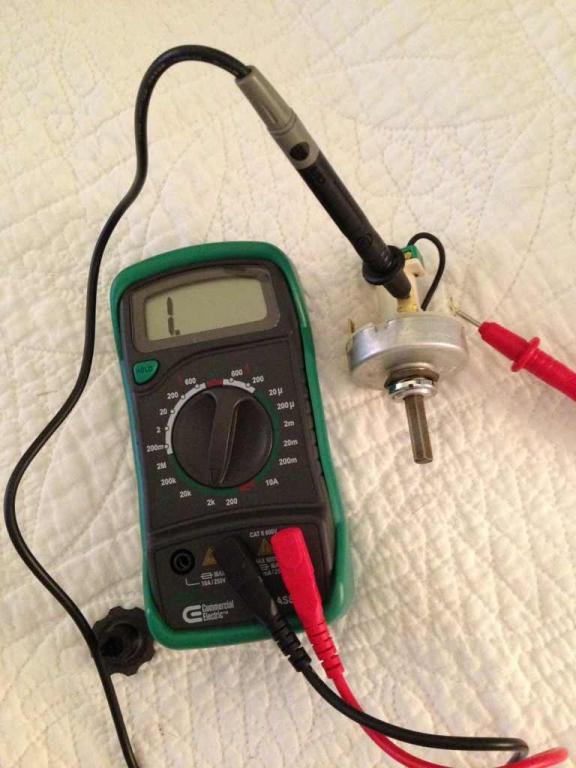

Knowing (or thinking) my switch was dodgy (one speed only) I figured that was the best place to start. I ordered a replacement switch and was able to get a NOS in original box.
So it came and I carefully swapped wires from the old switch to the new - one by one so as to preserve the correct order. I think one of the wires is a "park" function that brings the wiper blades back to bottom when the motor is turned off - just not sure which one does that - the blue wire or the red/green wire. My money's on blue.
No worky.
I broke out the multimeter and got 12v at the green wire into the switch. Checked green from the switch to the motor and got 12v there as well.
Ran a wire with 12v directly to the brown/green terminal on the motor - wipers work. Motor good (at least at one speed) and by inference, ground is good.
Checked for voltage on all 3 of the remaining terminals on the rotary switch as I rotated the switch - nothing. All terminals were cleaned and shiny. Still no worky.
Am I missing something? It's a dead switch right?
