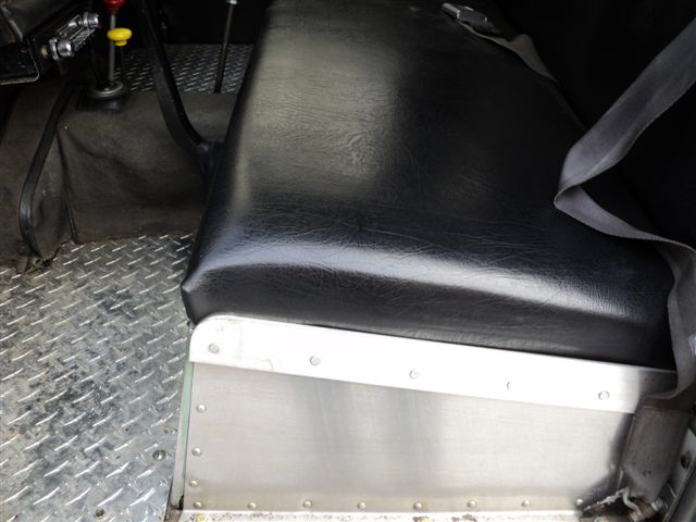

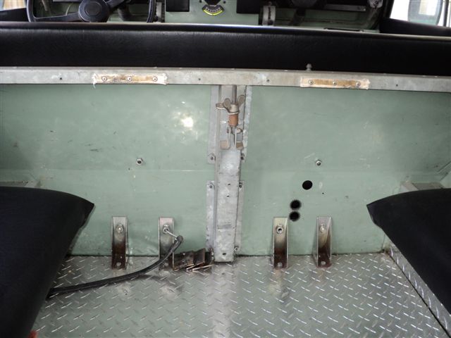

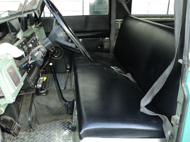

      You must be fairly tall too, like me I found it annoying to always be hunched over so I could see the stop lights and wanted the seat to be lower but that meant it also had to go back more. What I did was remove all the original seats and make a single bench seat from 1/2 inch plywood and glued 2 inch dense foam to it then covered it with the white material stuff (forget the name) then used black arctic vinyl to finish. It's held in place side to side by a strip of 2 inch X1/8 aluminum bolted to each side of the seat box then I used the leather strap for the original center seat positioned in the exact same place to hold down the front of the new seat. Next I did the seat back but before covering it I clamped it in position and drilled 2, 3/8 inch holes through the plywood and also the cross member then used 2 3/8 short cartridge bolts and nuts bolted through the plywood with the round head under where the foam would be. After the bolts were installed in the plywood seat back I then enlarged the 2 holes in the cross member to 1/2 inch to make it easy to align. After covering the seat back the same way but using 1 1/2 inch foam I then bolted the back into position. Now the seat base can be removed easily by just unhooking the leather strap and the seat back by just undoing 2 nuts. To protect the seat base corners I reused the corner protectors from one of the original seats bottoms.
      Before you do this just try removing the drivers seat and place a piece of 2 inch foam on the seat base and try it.

            This is about 10 years old and still in good shape. It is also possible to lay down quite comfortably in the front if need be.
