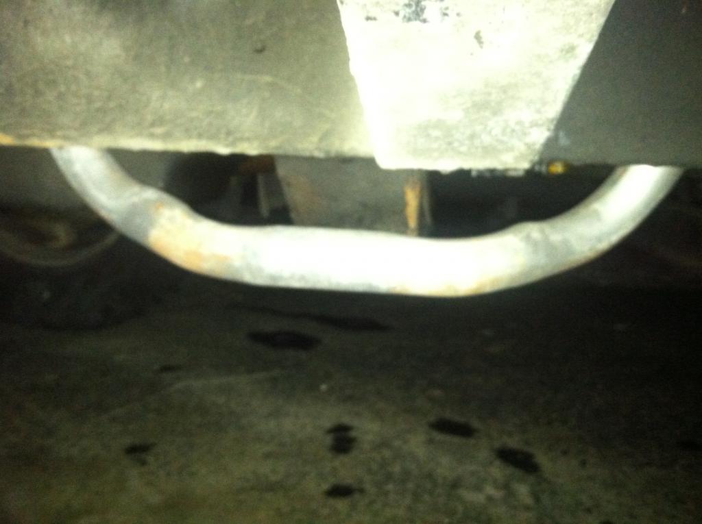

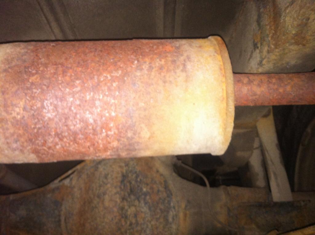

    If your going to go with steel don't buy the off brand buy the genuine Land Rover parts. See the attached pic of my muffler, that was installed 4 months ago. I have a hot water faucet outside my house and I wash the salt off the frame, exhaust and body everyday or every other day when the roads are salt covered. I replaced the whole exhaust system at the same time and the official land Rover parts look much better. I went with the off brand muffler because our host was out of stock of both Rover and Proline so I went to British Atlantic.
