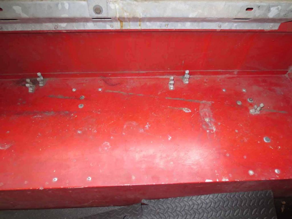

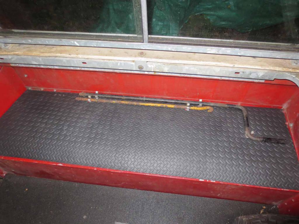

                      Here are 2 photos of the brackets that sit behind my left rear seat and hold the starter handle and the shaft for the jack. I suspect you'll find that the holes for the brackets are already there. My rear seats are not currently installed. I've added a rubber matt so the black labs don't slip around on the too smooth surface when they hang their heads out the side window. Click image for larger version
Name:	LR S3 starter handle bracket position a.jpg
ID:	167839 Click image for larger version
Name:	LR S3 starter handle bracket position b.jpg
