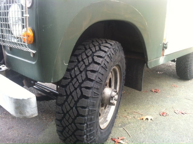

                              Don't forget about made in the USA
                              Commercial light truck
                              Love my Duratracs, killer in the snow. Never had them in the mud.
                              edit
                              ha-ha, old thread. O well I never miss a opportunity to plug made in the USA
Name:	new tires ft view.JPG

                                No offense but NC snow and Canadian snow is different. I have owned two set of Duratracs and find them unacceptable for full on winter use in new england. They are great AT tires, and ok for shoulder season (and perhaps incidental mid atlantic snow), but just an average all season tire capability when rain goes through phase change. After the second snow fall this past November even my wife was "can we swap out the Duratrac to snows this weekend, they are down right scary in the snow"
                                The Firestone MT I run on my '76 88 perform noticeably better in the snow than Duratracs, and come in 235/85/16, which is near perfect for series trucks, albeit they are made in Canada not US
                                The other very good performing snow and mud tires are the Super Swamper SSRs, even better than the Firestone MTs. I had an opportunity to try them this winter in the snow and was very impressed. They are going on my UZJ100 next, and they are made in US.
