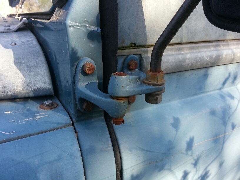

                  Here's my hinge-mirror mount:

                  • east high
                    3rd Gear
                    • Jan 2008
                    • 337
                    #10
                    [ATTACH=CONFIG]8119[/ATTACH]
                    That's the stuff right there. I went looking for these a few years ago and found a guy on LR Exchange who had them for $60 a pop.

                        #12
                        YAAAAAA Andrew 2A that is exactly what I am looking for. Is there any way to print out pictures like the one you show. I tried and it came out all black. Otherwise is it possible to send me a PM with a JPG. attached. That way I could show people what I'm talking about. Many thanks.
