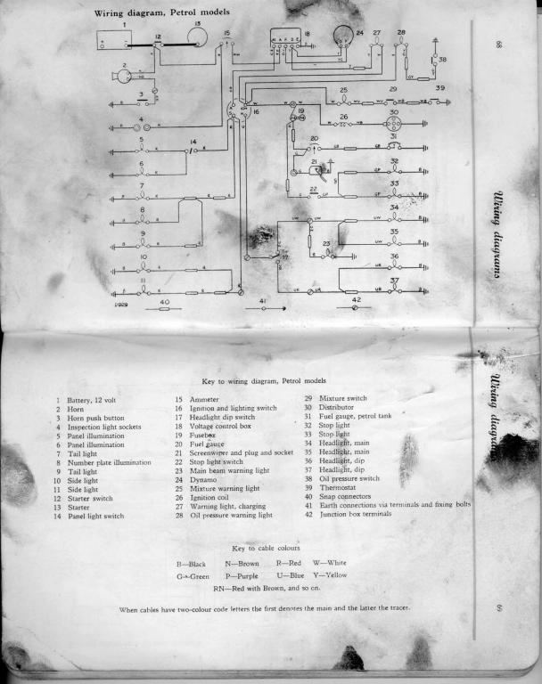

    Turn on the ignition.
    Put the transmission in reverse.
    With a multimeter set to read mid scale at 12VDC, measure between the Black (which should be earth or Neg.) and the other wires.
    Find those with a positive voltage reading and record.
    Move the trans to Neutral and retest.
    If the Voltage reading is no longer present at one of the wires and Earth (Black), you have found your operational pair.
    Good Luck...

      It is unclear from your post which side you opened up, Also are the wires comming up thru the tub or are they on the lamp fixtures? The LHD side will have stop/tail, signal, reverse and plate illumination. The RHD side will not have the plate illumination.
      As Dunerunner said the black wire is a ground wire and the ring terminal should be under a bolt or screw. The signal should be the green/red wire. In British standard wiring the reverse light is a green/brown wire from the lamp to the switch. Tail light, plate illumination are red and come on with the light switch.
      If you don't have a test light--get one, the repair manual is necessary too. This will help; Lucas wiring As can this link; wiring link
