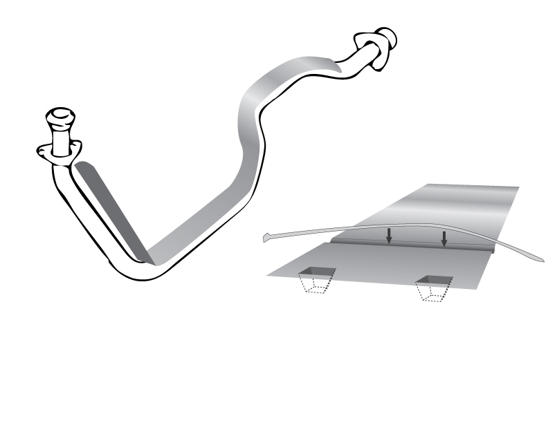

Anywhoo, so thinking of alternatives, I'm thinking a heat shield could be fabbed easily, and inexpensively. I mocked up a quick diagram of something I might try. Also learned a little about thermodynamics in the process or reading about it. Now understand a little more about how the intake manifold-mounted heat shield works ...
(It does put some heat back into the intake manifold, but it's better at RADIATING heat to the air than CONDUCTING it to the intake. The shield radiates heat from the exhaust manifold out into the air at something like 40 times the amount it radiates it back into the intake manifold)
My thoughts on the shield include some kind of (pressed?) standoff and some kind of channel to accommodate stainless wire ties. In aluminum, I'm thinking. Gauge? No idea. Galvanized flashing too flimsy?
So any thoughts, ideas, criticisms of my shadetree science, etc?
