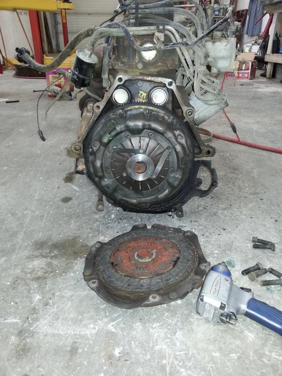

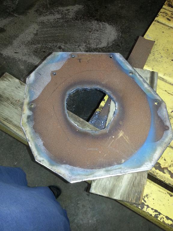

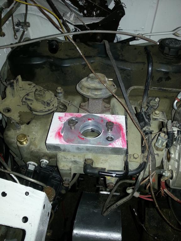

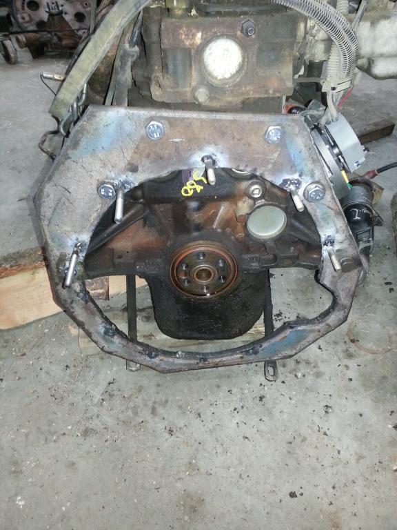

                  1964 109 installed a 1991 chevy iron duke made my own adapter..............and it works!Click image for larger version
