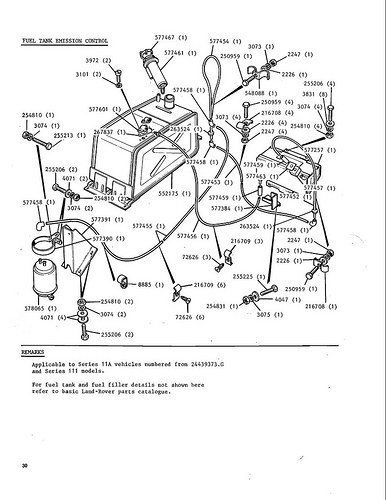

    Sounds like you got most of the emissions set-up. If you get a sealed oil cap you could buy the diaphragm emissions kit from our hosts to connect the oil filler tube to the carb. There was also an expansion tank connected to the gas tank and run to a charcoal filter through a series of plastic pipes, seen it on many ~1970 trucks, not sure if it was standrad equip on a 1969 or maybe an option. See attached.

      Looking at my oil filler tube I don't have a lip or rim to fit the radiator cap style sealed cap. Was there a sealed version for the straight filler tube maybe?
      I don't have any of the fuel tank emissions stuff. Looks like I just made the cutoff on that. (my serial 24435996)
