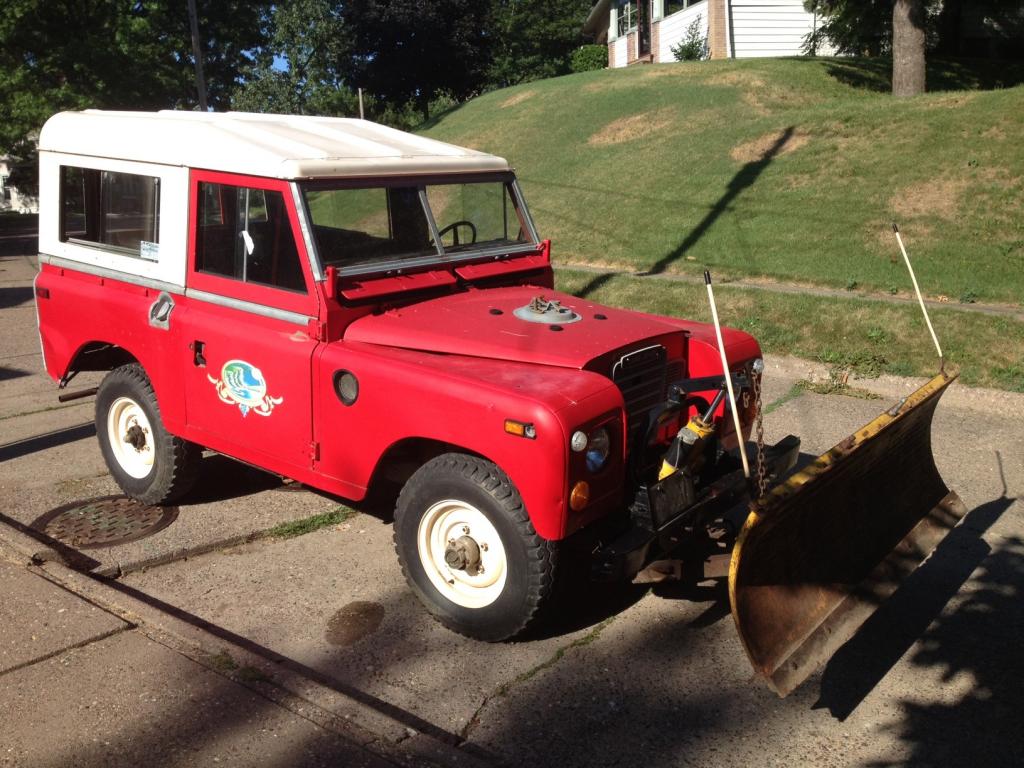

    Hello everyone - I am new to the forum and new to classic Land Rovers. I recently purchased a 1973 88 with the goals of having a fun vehicle to cruise around in and advancing my pretty limited understanding of vehicle mechanicals.
    My first project is to diagnose and fix the brakes. Right now the stopping distance on a flat surface with the brake pedal pushed all the way down is probably close to 150 feet. It eventually stops but it isn't safe in its current state. Based on what I have read in other forum posts the master cylinder looks like it could be the issue, but I wouldn't be surprised if the drum / shoes are also in need of fixing.
    With that said, I wondered if anyone could suggest a sequence to follow from removing the wheel, taking apart the brakes, and diagnosing the issue? The simpler the language the better as I really am starting with limited knowledge.
    Any help would be greatly appreciated! Thank you!
    PS - I attached a photo of my Series 3

    First off....get a shop manual, read it and understand what you're looking at and how the system works. Otherwise we're all just talking in different languages! Cool truck too...What is that symbol on the door?
    Jason
    "Clubs are for Chumps" Club president

      Looks like a great truck, love the plow setup! Where are you located? And welcome to the club!

          Thank you for the input and the compliments! I am located in the Quad Cities and purchased the vehicle from a nearby winery owner (the logo on the side is that of the winery). I love the vehicle and am looking forward to getting it to the point where i am comfortable driving it. I have the green manual on order now and hope to receive it in the next couple days. It sounds like that will be instrumental in getting started on the brakes.
