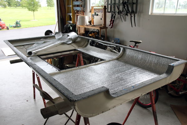

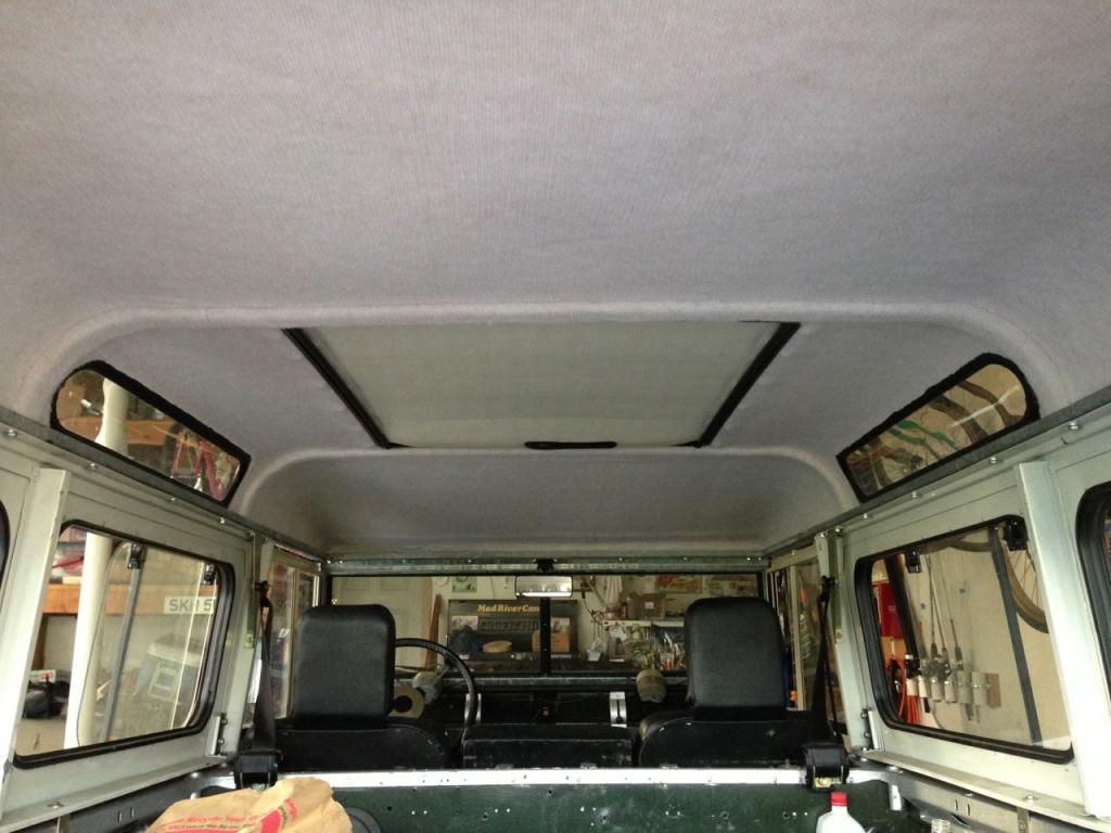

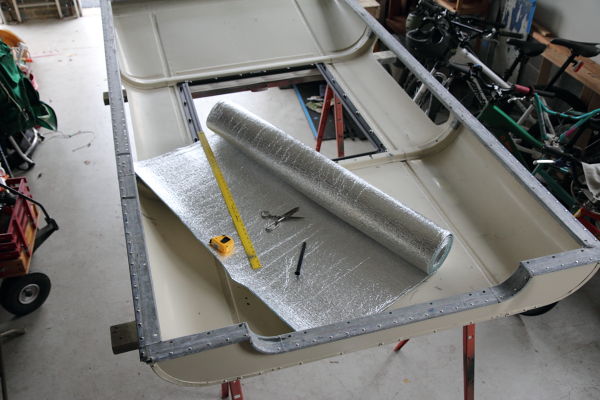

              Max,
              I used EZ-Cool insulation and marine hull liner. The EZ-Cool is almost weightless, and foil backed so it provides decent insulation.
ID:	168136Click image for larger version
              Here is the finished product...
