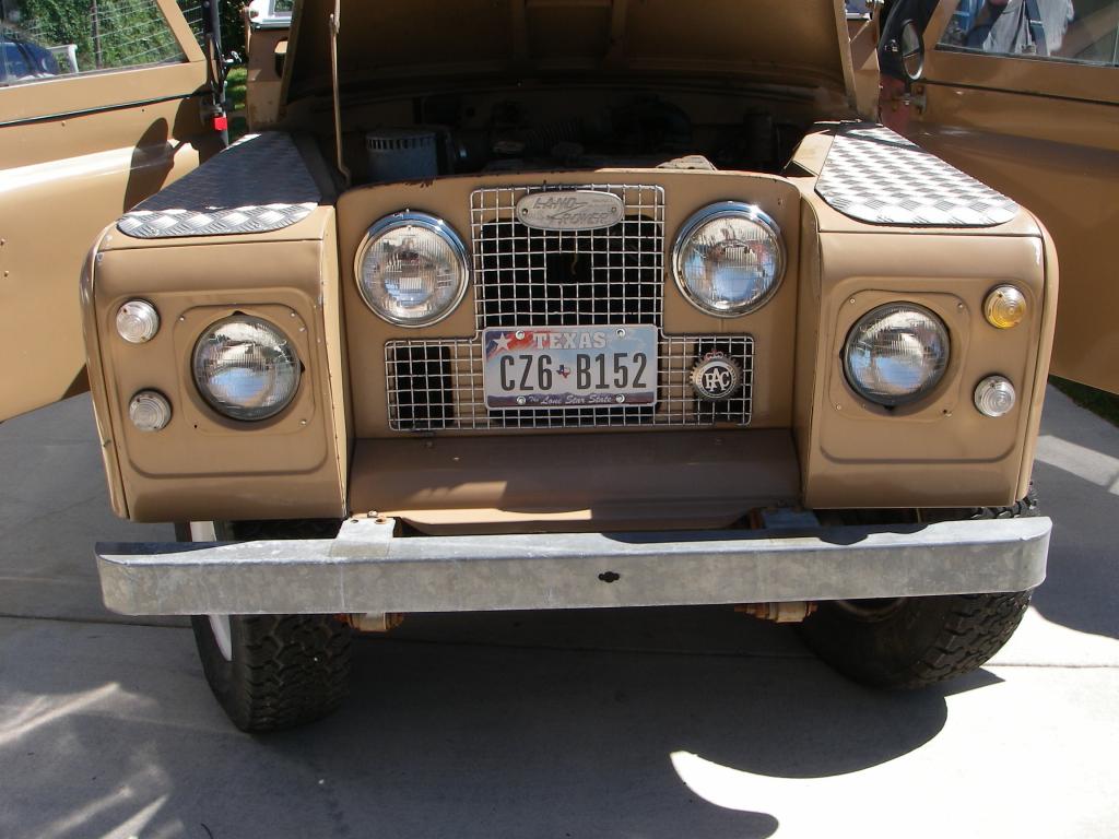

This truck looks like it has replacement fenders (wings) as they have headlights and turn signals along with headlights inboard (on the breakfast?). My guess is that somewhere along the line newer model fenders were added. Should this raise any flags?? What else can I check to make sure its not a franken monster????
