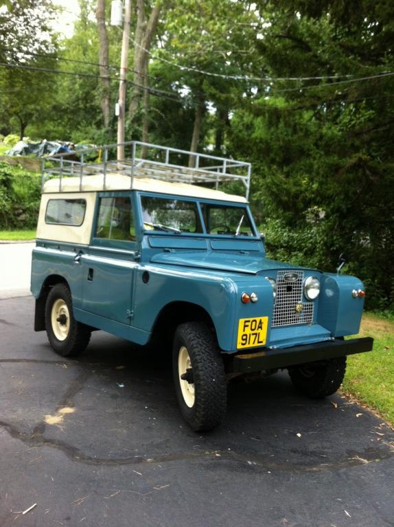

            This is the truck before restoration. Only modification will be parabolics that should increase the ride height, but this is with 235/85/16s, some old DAP springs. Not sure what kind of rack it is, sits in the gutter rails.

              My 109 ExMoD, with 32" tires and Parabolics, sits about 83-inches at he hardtop ribs. My garage doors are 8ft. openings, with ~92-inch clearance. I have not yet installed my roof rack to check the actual clearance, but ~9-inches should be do-able.

                You said you are replacing your garage door but didn't specify height. Unless you have go kart wheels under your truck a Series truck with hard top and roof rack is likely to be taller than a standard 7 foot garage opening. If you can raise the header above the door for an 8 foot opening I suggest doing it. Otherwise you need to loose the roof rack, stay with a stock tyre size and be careful about adding any suspension that adds height.
                My Dormobile is about 7'4" and has to live outside in the snow because my garage will not allow me to lift the door header without first lifting the roof
