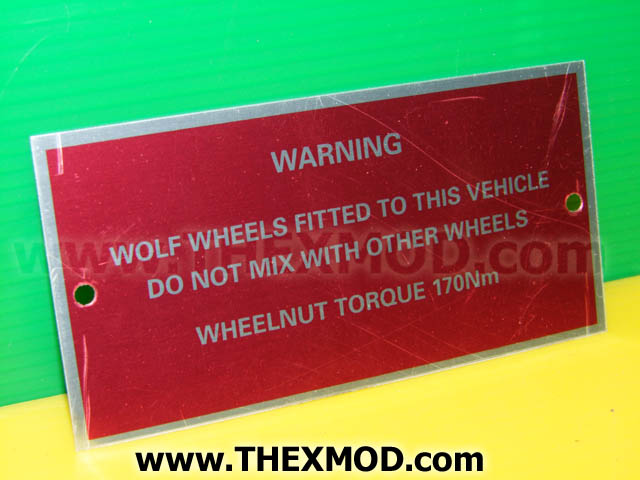

      Its 100lbsft for Wolf rims. There is a sticker for it that would be fitted to MOD trucks.

            This is the MoD plate for Wolf wheels as retro-fitted to 110's.
