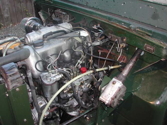

                Ive had all the various boxes 80s - SI,SII,SIIA and SIII - SII/A works ok, but if I were to do it again Id shorten the inner and outer column to match 80 length and use the late Series one horn bracket and steering wheel center. Heres a pic of a plain old LHD SIIA box mounted in an 80 - mounted right side up. I drive a 53 daily and just use the original box, it doesnt give me any trouble.

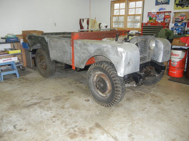

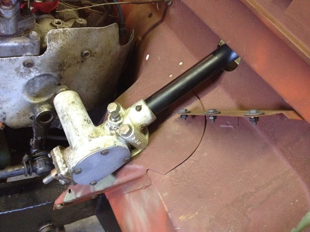

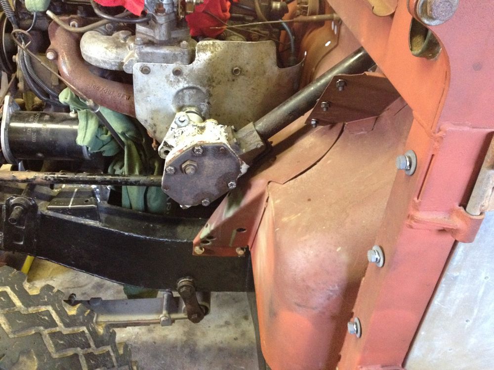

                  Thanks for that picture. After test-fitting with a SIII RHD steering box, I'm going to follow your advice with the original 80" steering box.
