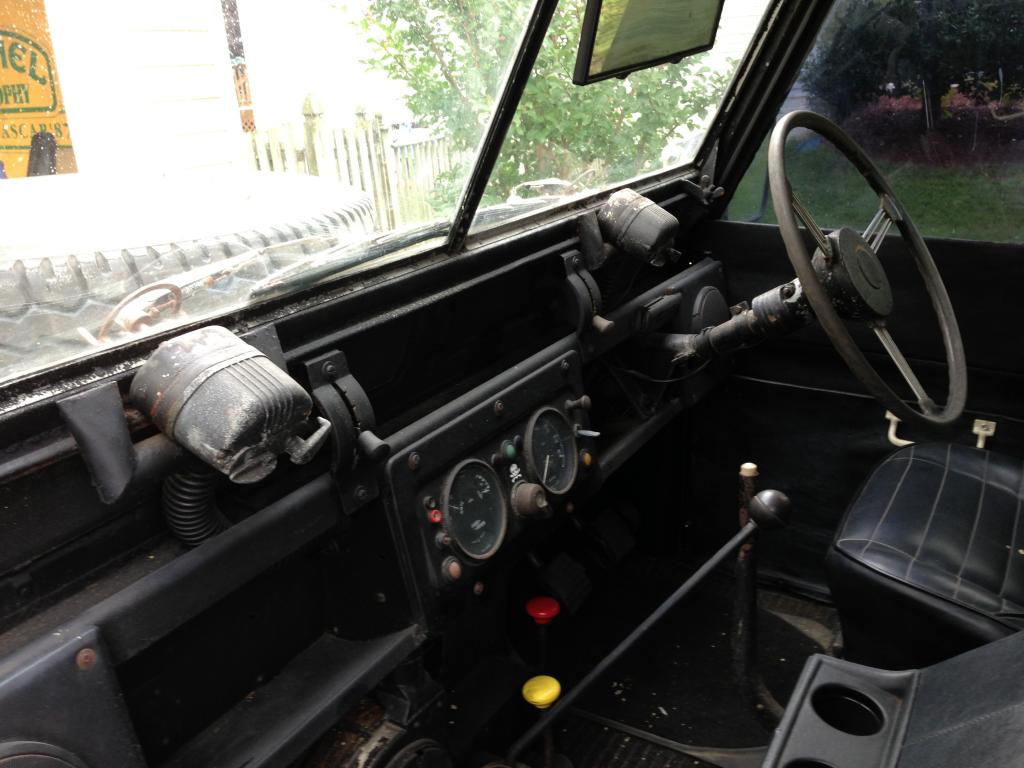

'63 109" I had was wired for sound. The speakers were located - 1ea in the dash, mounted onto a piece of wood that was carpeted, then 1ea in the C pillar, about head high to someone sitting in the rear bench seat. Sorry no longer with me, so I don't have too many pictures. You can see in this pic the dash mounted speaker in the cnr of photo.1963 Series IIa 109" 5 door Safari top (SOLD to new home)
