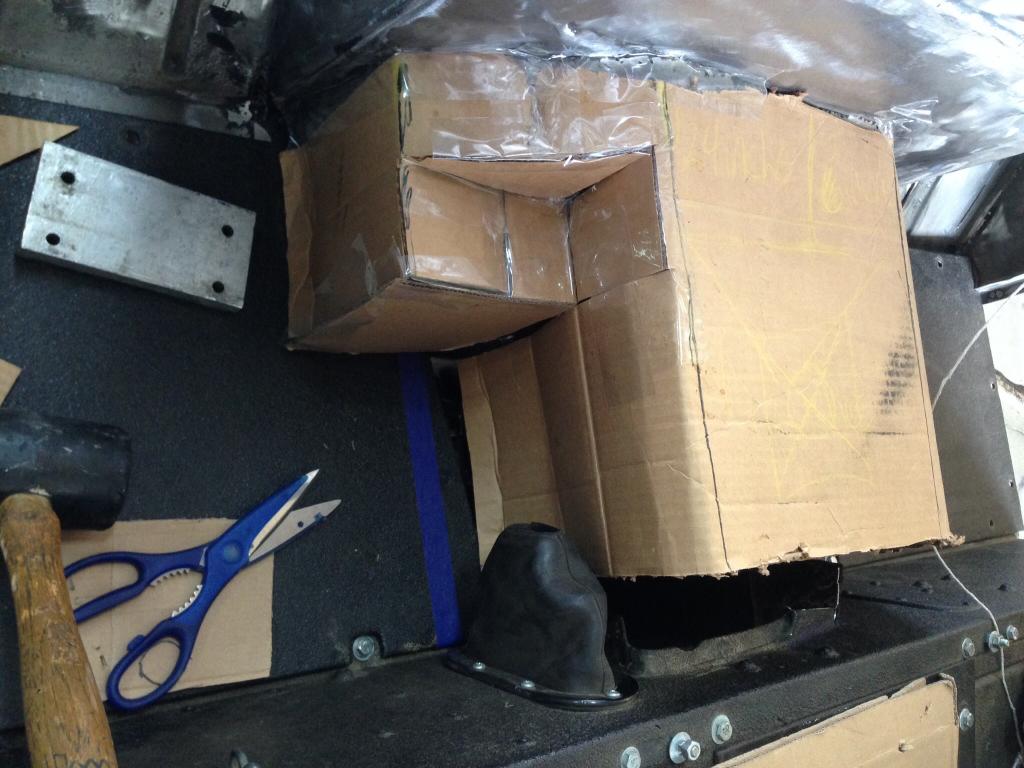

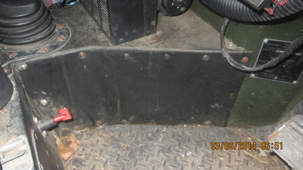

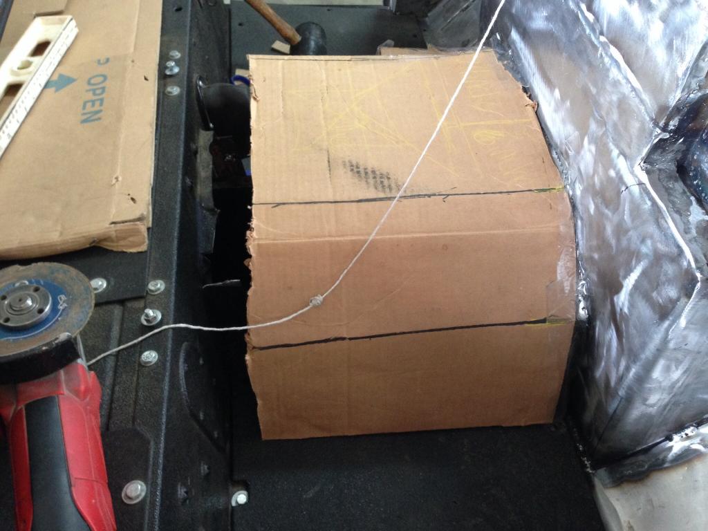

          This is what I am thinking of something like this . I would have the rear of the tunnel attach to the top of the seat box and I would make the transfer case levers longer

            Something in the cab

              For the R190 install in the wife's 109 I made up a framework using thin angle and then fitted sheet metal to cover the framework. The angle was slit where it needed to bend, and the sheet metal was covered with vinyl with dynomat on the underside. Other angle was attached to the seat box and the bulkhead for the tunnel to attach. All held in place with screws.

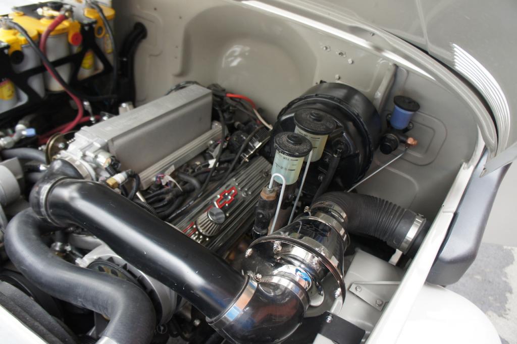

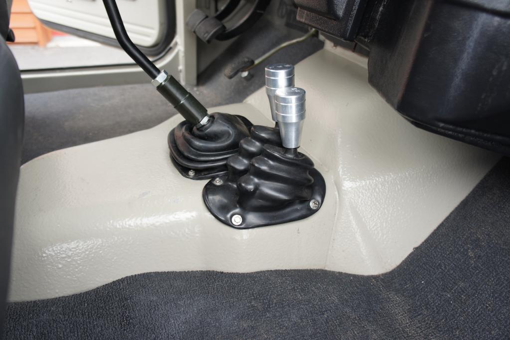

                Derek,

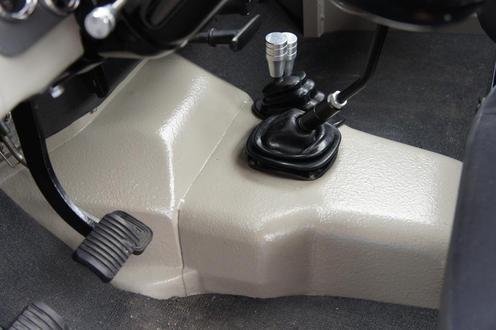

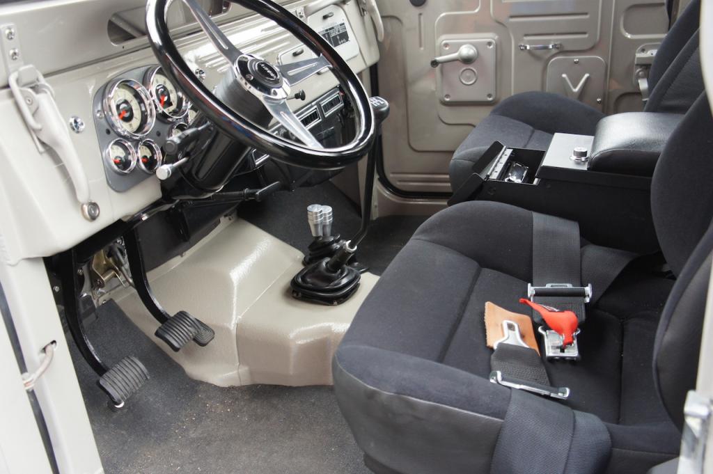

                Sorry it took so long to get you these pics of the interior with the NV4500 in the FJ45. Hope these help.

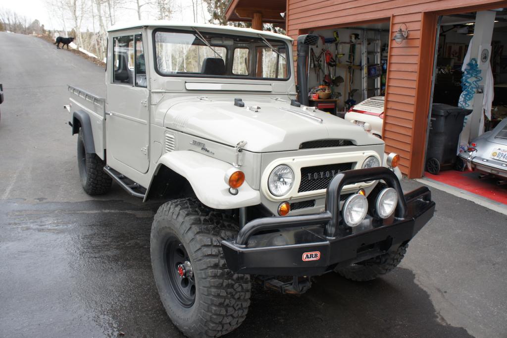

                Rover John, I also attached a few pics of the Truck. Long Bed FJ45.

                      You must have recently picked that 45 up from Redline. Nice 45 for sure..... or should I say 1994 HZJ75 FWIW, that's my old frame, suspension, and axles under that truck.
                      Derek: I think you are on the right track with your cardboard mockup. Just make sure you have enough clearance with the parking brake handle and the tunnel.

                        Right you are. Ive followed the truck bit before Red Line conducted the sale. So do you live in Pagossa Springs? Frame is the strong one indeed, axles in it are? Ive been chasing some leaks from the NV4500 (that strange gear oil it requires @ $30/quart likes to find any possible way out, even casting porosity, (fixed with some application of Permatex super Black), small radiator leak, wind whistle etc.all fixed. Also the A/C was never connected, although everything appears to be there all I need is a wiring pig tale and check the A/C coolant. Altogether the final purchase came together nicely, the owner and I came to an agreeable arrangement with
                        Red Line being the intermediary. Its now the roommate to my Bug Eye 88 and a few other old vehicles. So did you know Paul before he started the resto in Pagossa? Did you own the 94 HJZ75 for long? The frame itself looks very solid as does the body. Suspension and shocks are nice and it rides very nicely for a serious truck. It handles the 2000 ft. climb I do to come up to park City(7200 feet) from Salt Lake(4200 feet). Small world! Could not duplicate it for the $$, even if I found a straight 45 to start.

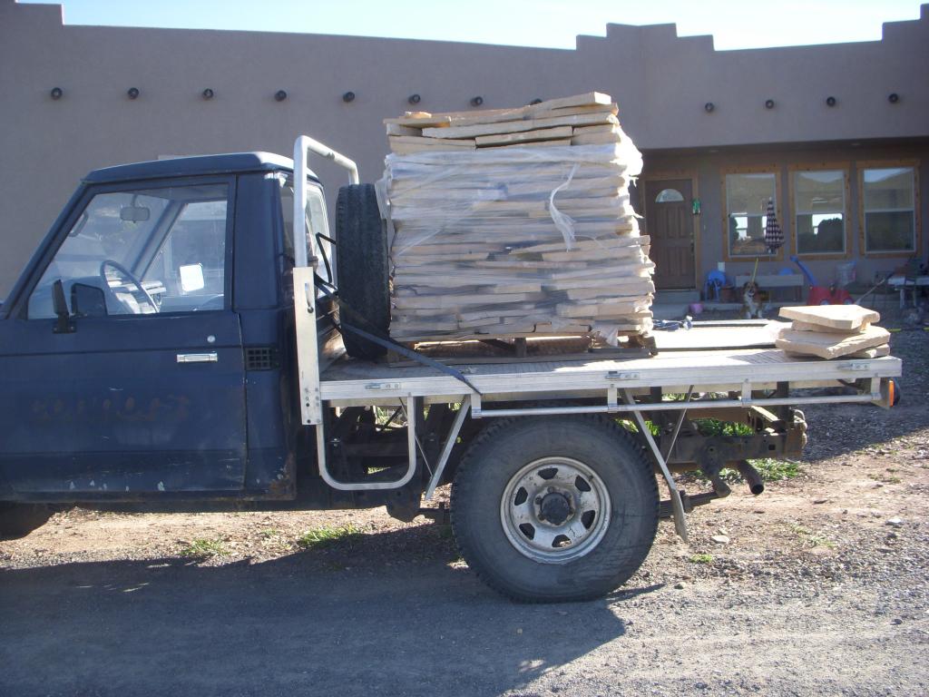

                          I will be heading back up to SLC here sometime soon as I still have quite a few vehicles up there. I have lots of Cruisers and a few of them are stored out in Heber at a buddy's barn. I'd love to check out that 45 of yours as I never got to see it once Paul finished it.
                          Derek: Sorry to hijack your thread. I had another thought for you: hit up "bluebomber" here on this forum for some pictures. Matthew works at Advance Adapters and has a 88" with 350/SM465. He had to make some tunnel modifications and I am sure he would share some info with you.
