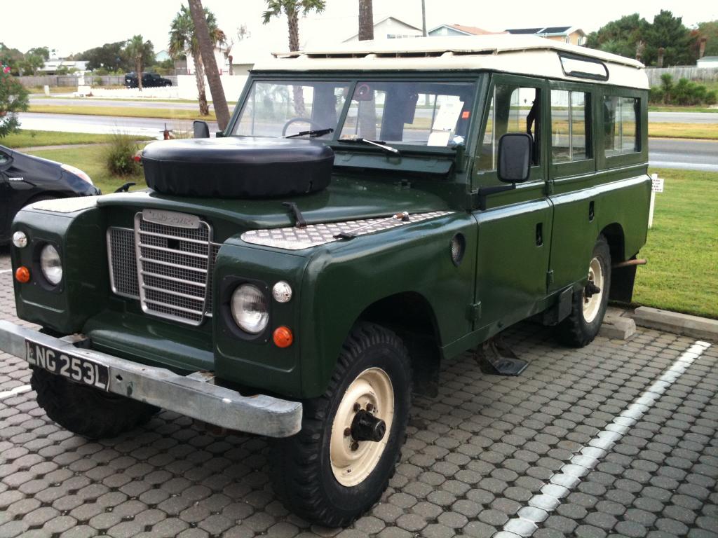

                          This is how it sits today after the parabolics. Its roughly an inch higher on the other side.

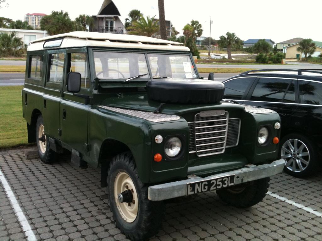

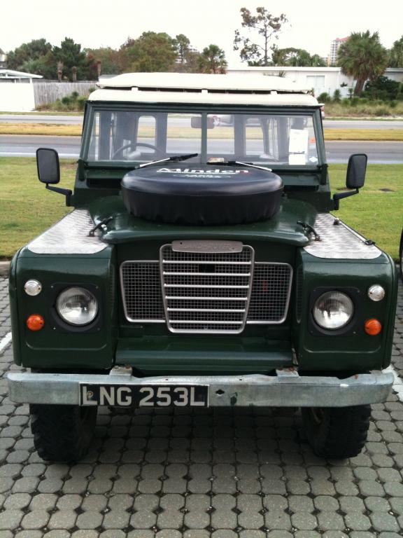

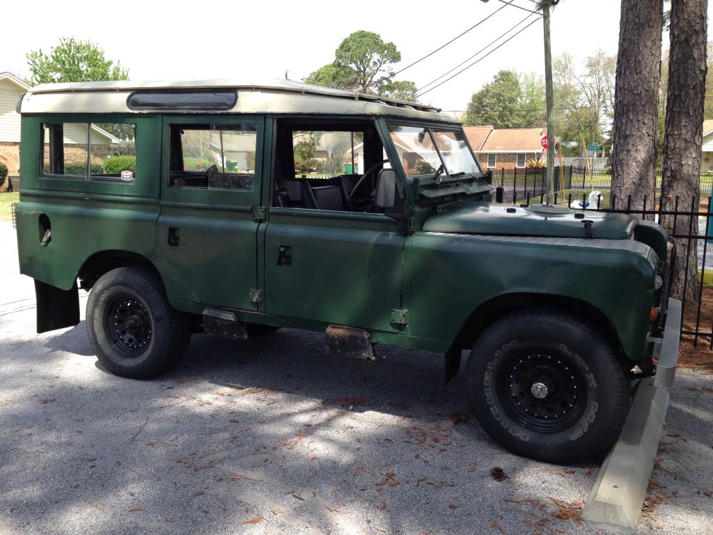

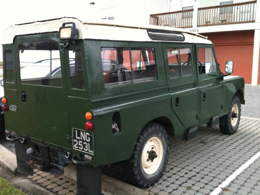

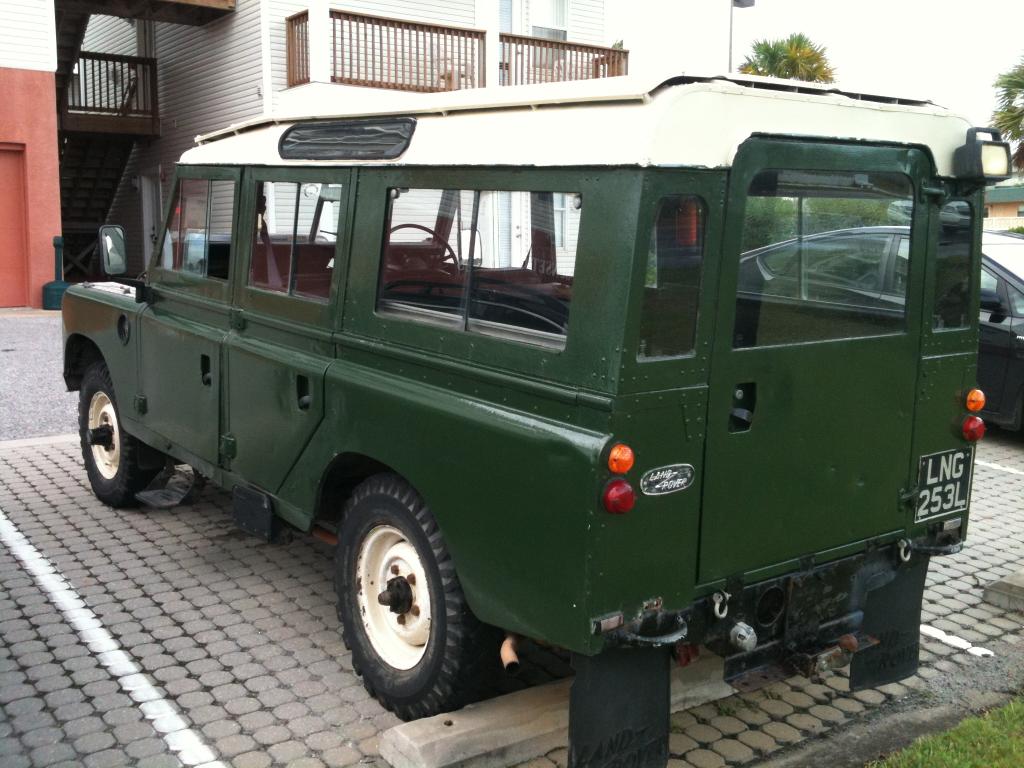

                            Found these pics. I had just painted her before these.
