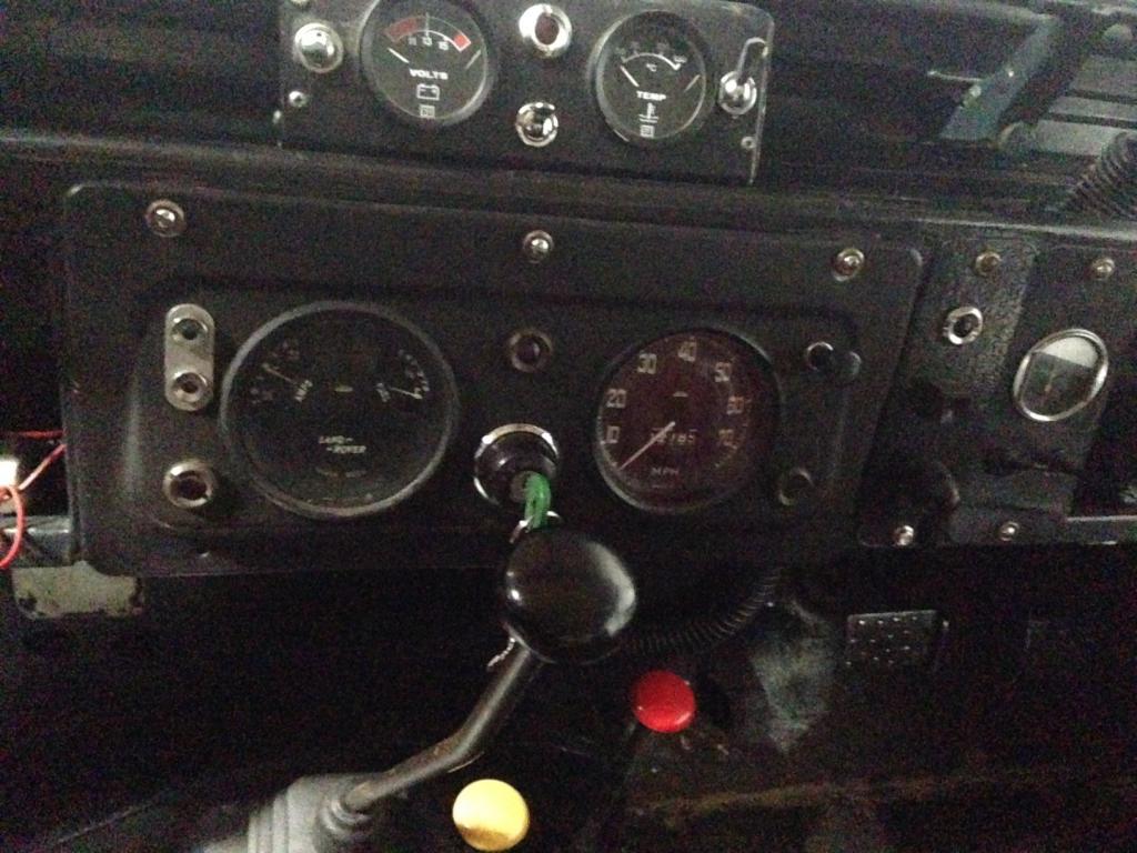

            Thanks friends. Another question- since the electrical system has been modified many things may not work as they should. What should the lights on the main panel indicate? The only one working is the red on the lower left. Any time the engine is running its on.

              The lower left light should in fact be green... It is the low oil pressure light... The top/middle light should be red (low charge)... The bottom right light should be yellow???? I got my rover without the lens over the light.. That is the mixture light (if the choke is out too long)..... Have you picked up the parts manual? I view it as an amazingly valuable resource... Along with the Land Rover Series One Club forum (LRSOC.com)

                Interesting! Actually, I should have given you more information. It's not the original motor. Based on the fact that there is no serial number on the engine block in the normal location and it has a Weber 32 34DMTL, I believe it's a 2.25 petrol from a 90. I can't find an oil pressure sensor, and the PO put a voltmeter up above the panel. How does it sense mixture? In any case, I still have a lot of work to do just figuring out what will fit. (The axles are Series 2a and the transmission S3 with a Fairey Overdrive.) Frankenstein. What are the two lights vertically mounted on the upper left?

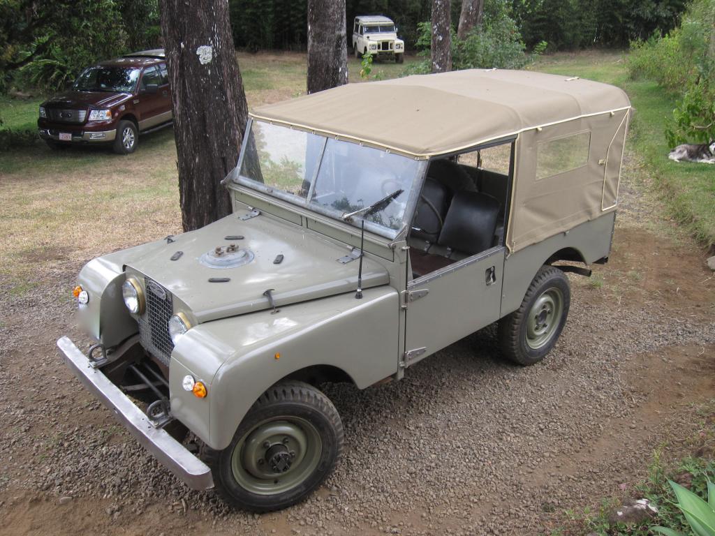

                  Welcome to "the club" Buster. I also have a '58
                  Lucky you don't have the OEM 2.OL engine, its taken me almost a year for me to source all the rebuild parts for it. If you get into a bind on (non engine) parts LMK, my mechanic has (3) SI parts trucks we use to cobble together whole trucks. Our next "roverhauled" truck will be a '56 86.

                    If the carb is on the passenger side (LHD), then it's a 2 liter.. The 2.25s all have their carbs on the drivers side. The oil pressure sensor will be electric... It is usually around the oil filter housing... As far as I can remember. And as for those two lights, I have no idea. From the factory those were positive and negative plug ins for accessories.

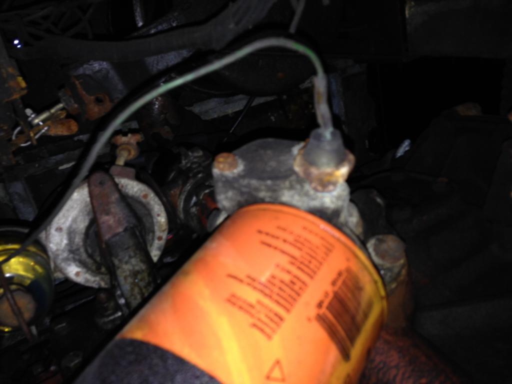

                        for a 2.0 the oil sensor (for green idiot light) is at back bottom left of the engine at supply end of feed pipe for the rockers. For 2.25 at filter housing.

                          Here is the old sensor. I need to check and see if it has electrical power. Pretty sure it's kaput.
