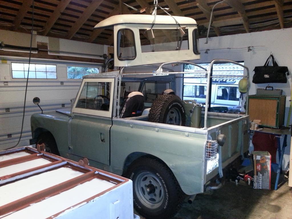

                  Mine is not nearly as cool. I just used the winch off a boat trailer plus some ratchet straps to hoist my pickup cab off my 88.Click image for larger version
