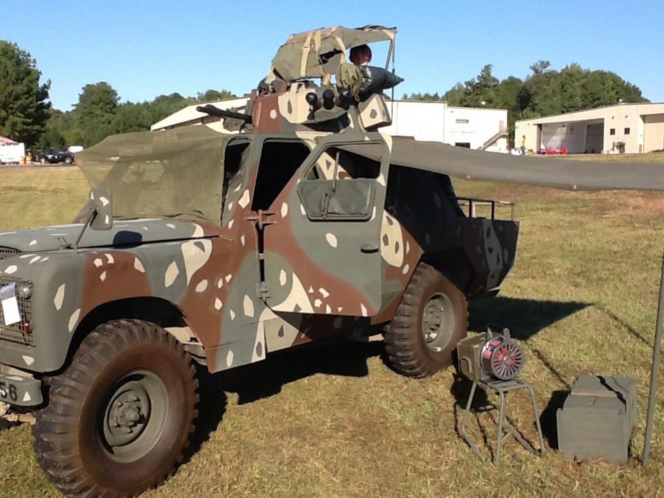

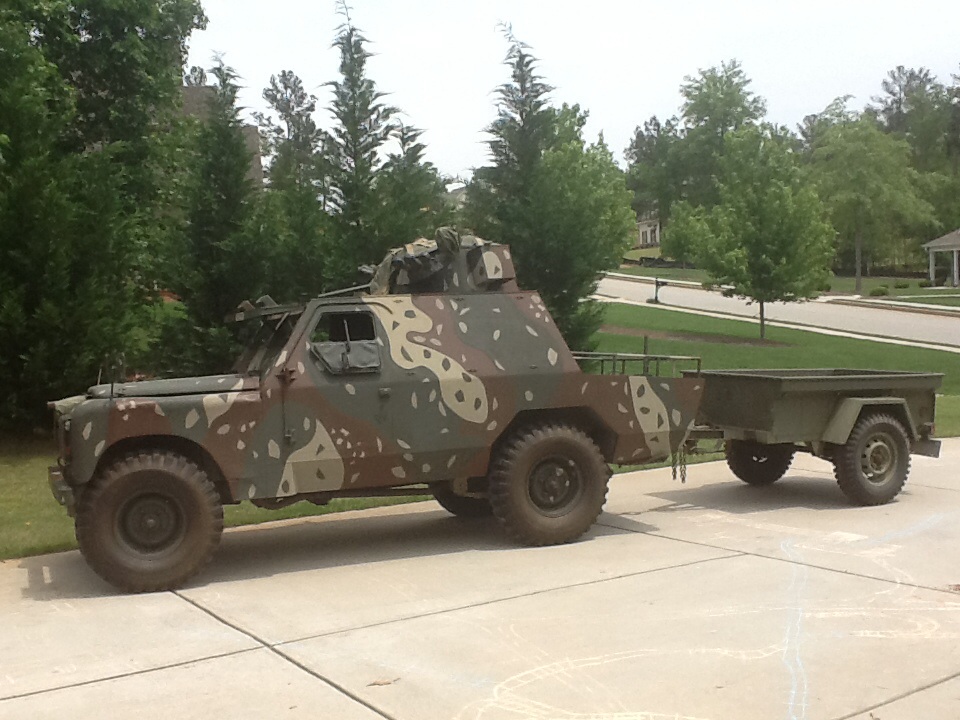

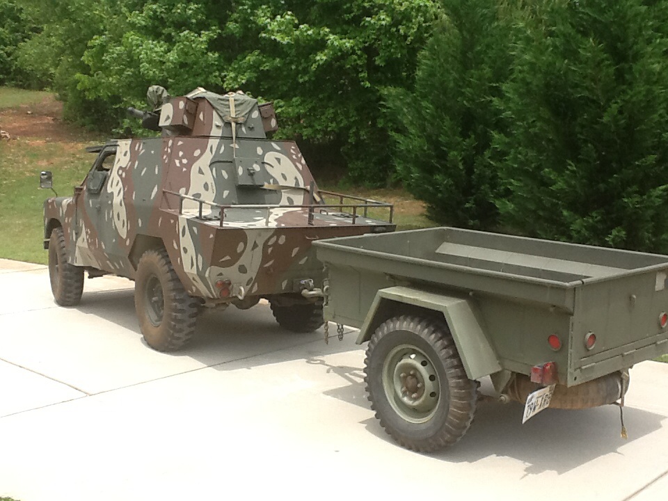

Hello, I need some advise please. My 1972 Shorland's clutch gave out last week at our local MVPA meeting. Has anyone changed the clutch, pressure plate and throw out bearing on a 1972 Shorland Armored Patrol Vehicle? I am planning to change it when I get the parts from Rovers North and some time. My 1972 Shorland has the in line six cylinder, and I assume it was built on the 109 one ton frame.I have talked with a Rover North sales rep and he thinks it would be the 9.5 inch clutch plate I need but until I pull it out I do not know for sure. I would like to have all parts on hand and finish the job in one day? All comments, advice, info appreciated.

I imagine it's simply a stock series clutch setup. However, before you go ordering I'd make sure you know what transmission you have, IIa or III. Don't take it for granted that the tranny and clutch arrangment matches the year. You should be able to get it done in a day provided you don't go off topic with other items "while you're there".
Awesome truck by the way!Jason
