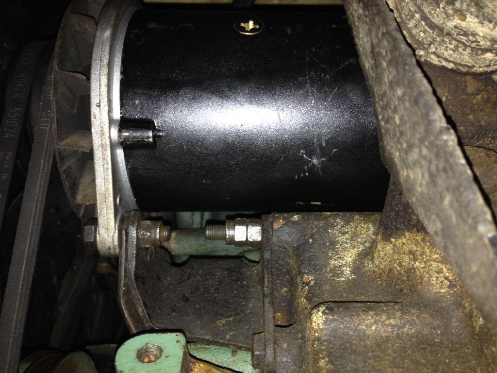

      I just went through this nutroll on my 71 IIA EX MOD. To make a very long story short, I replaced my C40 Dynamo (probably like yours) with an Alternator that looks like the C40 and uses the same mounting brackets. The dynamo has two bolts on the bottom. The best way to access them is from underneath the Rover. You'll need a good flashlight, a good offset box-end wrench and a socket wrench set. Also, pop a couple of 20 mg Lisinopril before you start. An assistant is also helpful. You'll need to first remove the rear connector (D) and the warning light wire hooked to the top of the dynamo. Then undo the adjuster bolt on top. The dynamo will fall towards the engine. Then get underneath and take the remaining bolts off. Take pictures BEFORE you do everything to help you remember how it all goes back together. I've attached a photo of my dynamo taken from underneath. Click image for larger version
Name:	Lucas C40 Dynamo.jpg
