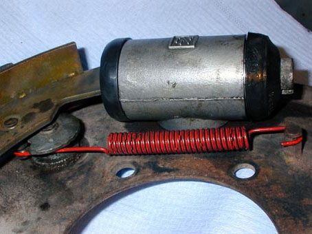

        Double check to make sure the brake shoes and springs are set up correctly. Just went through this on my 1971 Series IIA 88" where it took two pumps to get good pedal pressure. Turned out that the last person to work on the truck improperly hooked up the brake springs--connecting the two shoes together which did not let the shoes to move out enough to contact the drum. The correct spring location is to a securing peg. Once that was identified and corrected the brake pedal was fine and firm and brakes worked great.
        See this write up and thread for lots of good pictures and info on adjustments that might help:
        http://www.series2club.co.uk/forum/f...p?topic=6606.0.

        See also TerriAnn's website with similar explanation of this issue:
