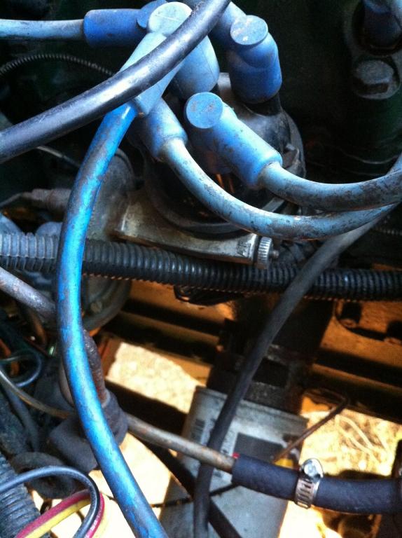

        Well, tonight I messed with it some more but go not progress. I did record a video of it running, to see if anyone might have suggestions there. In the video I was holding the choke plate open, but the high idle was active from the lever supporting the throttle plate. It tries to die at one point. It is running very lump in the video, but i think it's hard to tell past all the sucking noises from the carburetor. Any suggestions?
        Also, would adjusting the thumbwheel on the distributor have an effect on the slow running if I have the Crane points conversion unit inside? The book says to initially set it at four lines showing on the vacuum tube side, but I can't see any marking there, so I set it in the middle-ish.

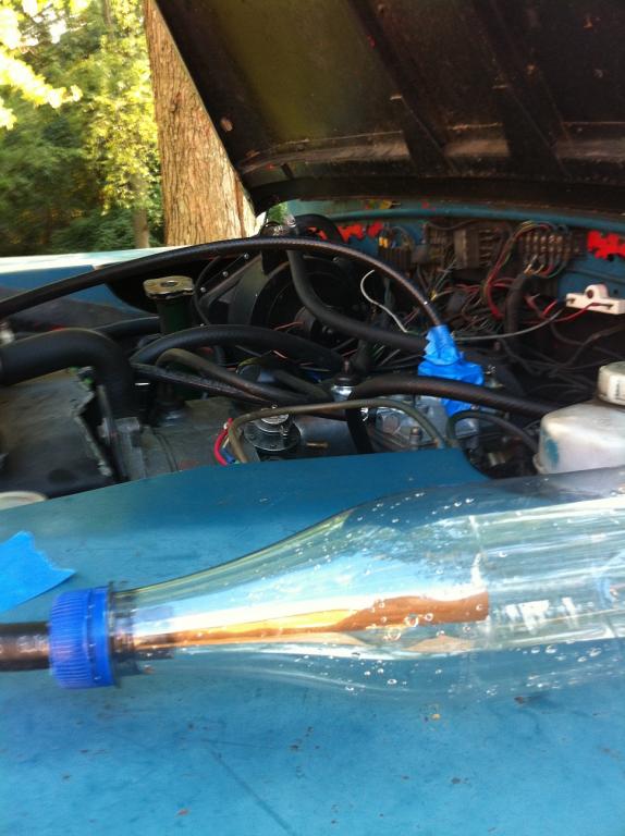

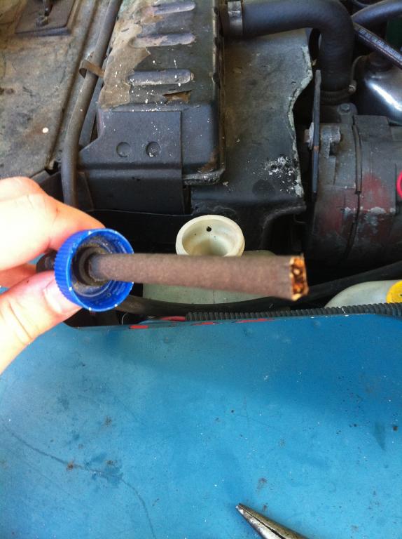

                So, tonight I made a smoke device out of some tube, a cigar, and a water bottle. It worked really well at generating smoke, but for better or worse, the only place I could get smoke to come out of, and only then under reasonable pressure, was the part where the choke shaft enters the body. Also tried pushing it through the brake booster but couldn't see any coming out of there when I tried.

                The smoke coming from the shaft.

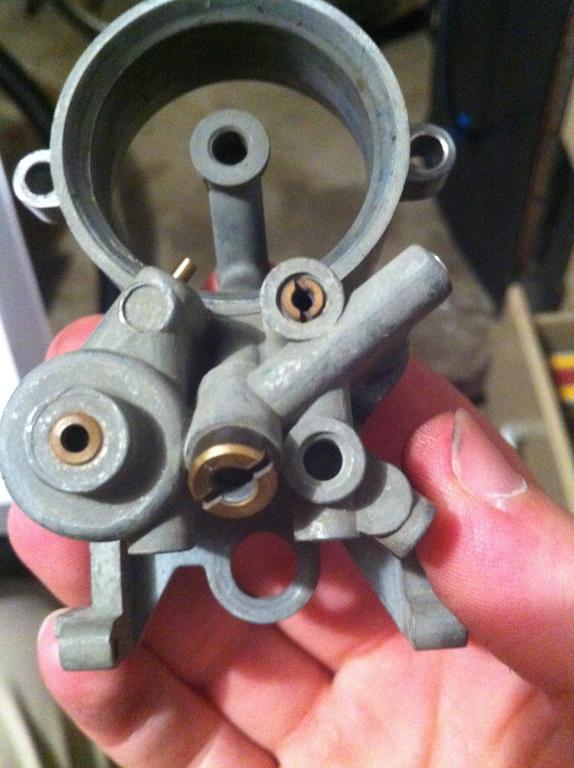

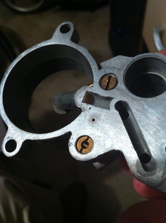

                So, after that was done I pulled the carb off again and opened it up.
                I have the black plastic floats, and one of them has been filling up with gas. I had sealed it with some fuel-resistant sealer, but it has not worked, it was full again. I'll use JB Weld this time and hopefully it's better.
                Otherwise, I unplugged the economy vent port, and blew out all the slow running tubes in the emulsion and top plates, in hopes that it might get better. Does the slow running jet have a little spring valve in it? I was wondering if the rebuild kit spring worked a little different than the old one, so I cleaned the old one out and put it back in.
                I'll try to reassemble later this week, and provide an update then!
