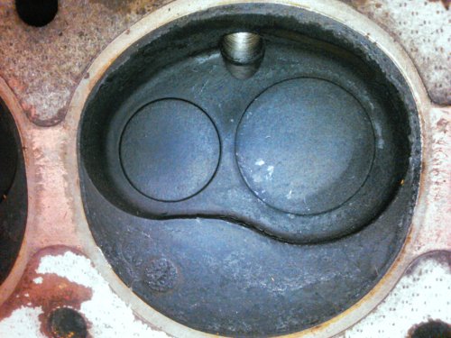

      As requested, pictures of the cylinder head. First is #2 which looks great along with the slight impression of the washer in the carbon.

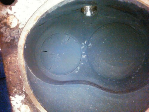

      The other picture is of #4 which looks like it has some issues. I presume that is the intake valve with the splits in it. Anyone have a guess what would cause something like that?
        [ATTACH=CONFIG]10322[/ATTACH]
        Exhaust valves are always or almost always smaller than intake. "Intake valves are usually larger than exhaust valves because pressure forcing charge into the cylinder is much lower than that forcing the exhaust gases out."
        The cracks are kind of odd but somewhat similar to some burned valves I've seen. http://www.aa1car.com/library/ar1192.htm

          #2 looks OK if the pistons 2 and 3 have the same measurements at the top of TDC. As for #4, Yorker is right is saying this is not good. The burn and cracks on #4 exhaust are not indicative of a healthy environment there in #4. Does not explain why the engine came to an abrupt halt though. There could be some other "surprises" lurking in this engine.
