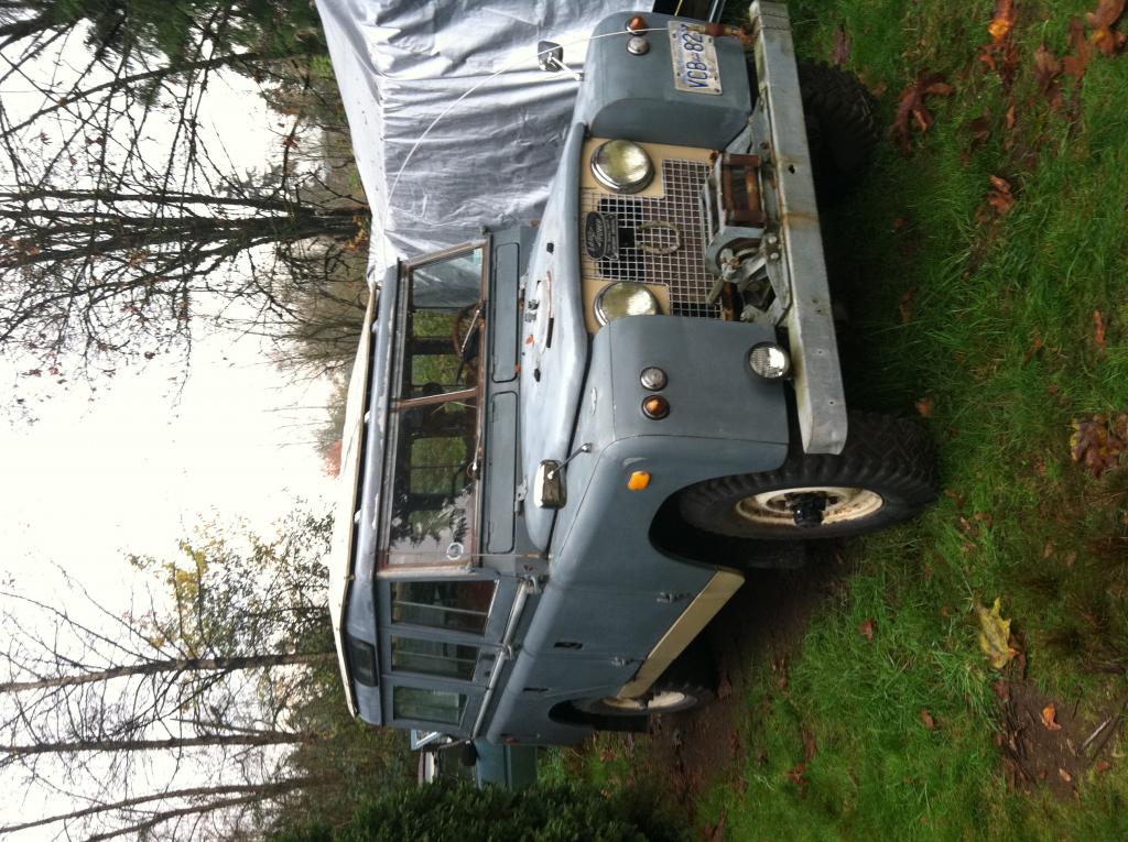

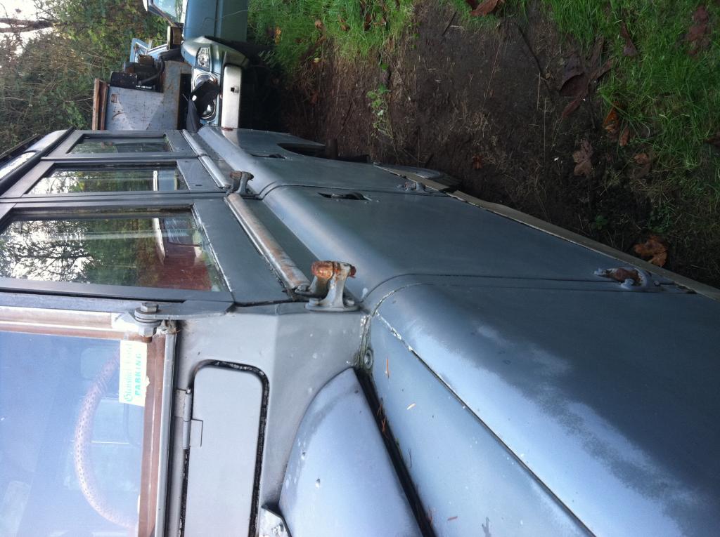

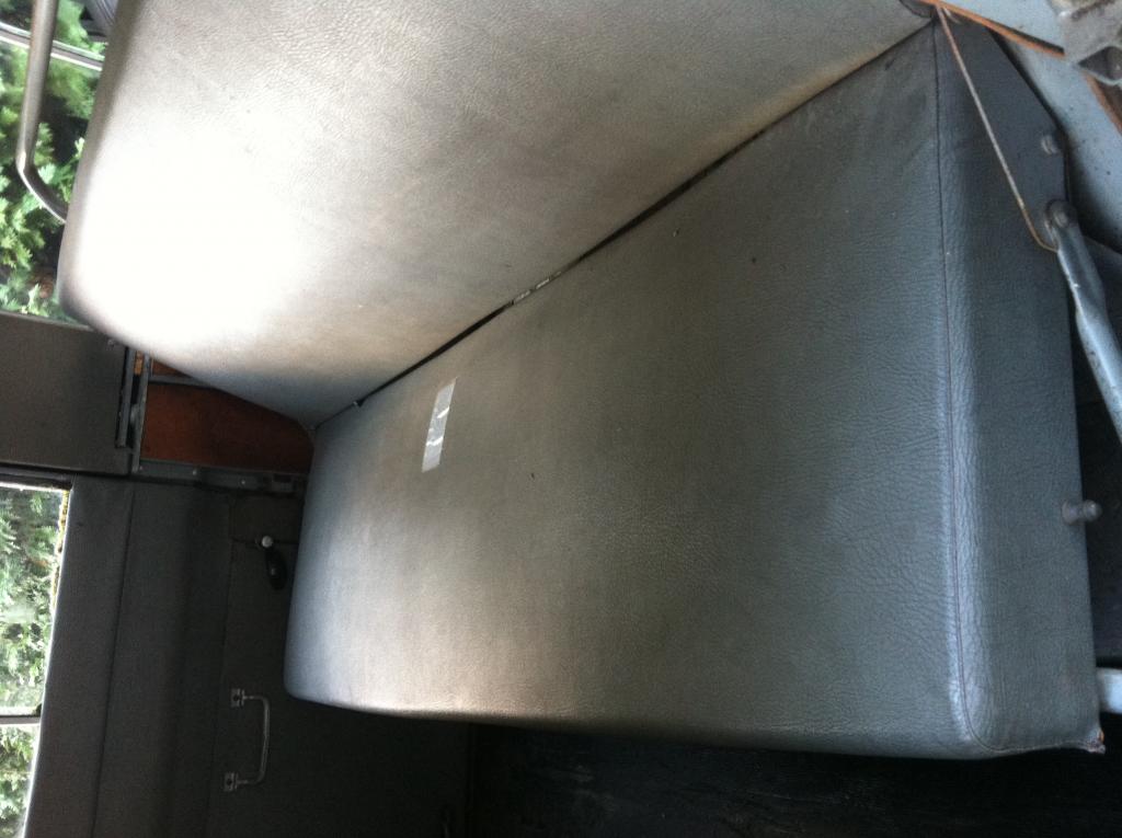

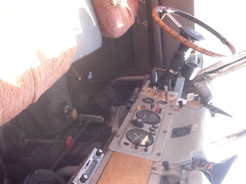

    Hello all. I am new here on the forum. I've owned many different land rovers and did a full frame off resto on a 73 Series III 88 back in 2003-2004. I'm from Virginia, but now live in Seattle. Just a little background.
    So here I am considering a 1963 Series IIA 109 for $4k. It's a pretty unique truck with all of its history and I am pretty much in love with it. It even has the original bill of sale. It's a LHD originally purchased in Switzerland and then almost immediately shipped off to North Africa where it spent close to 20 years before the person moved to Vancouver and brought the rover with him, where it has now spent the last 31 or so years. It has been sitting since about 1997. That was the last time it was registered.

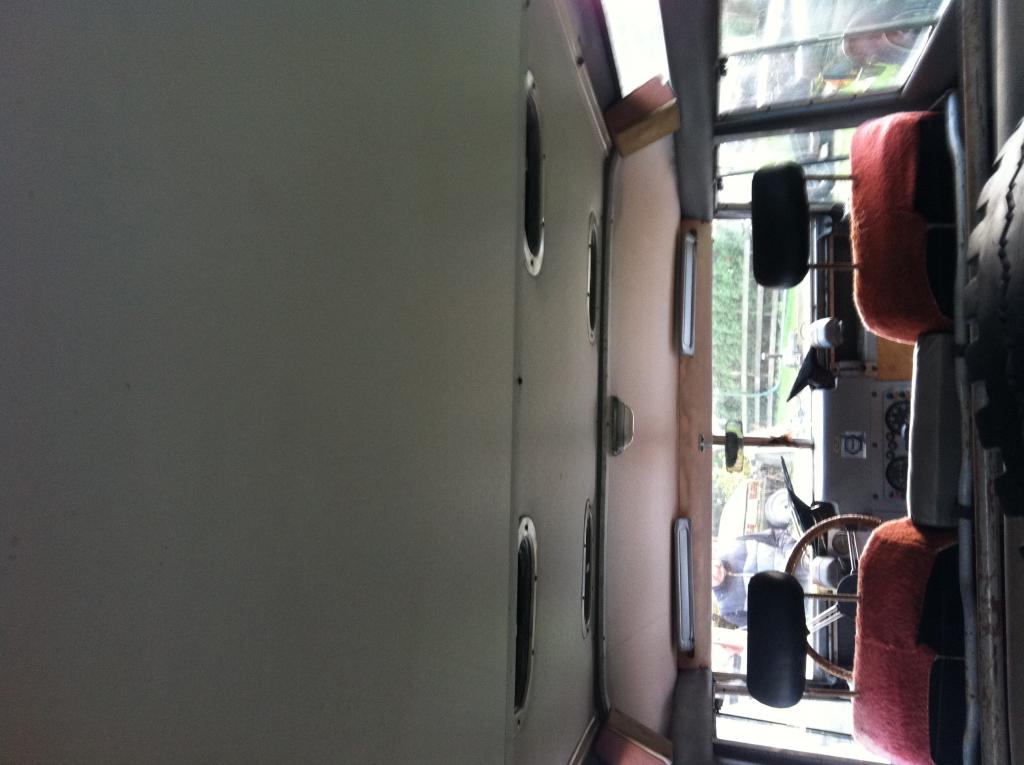

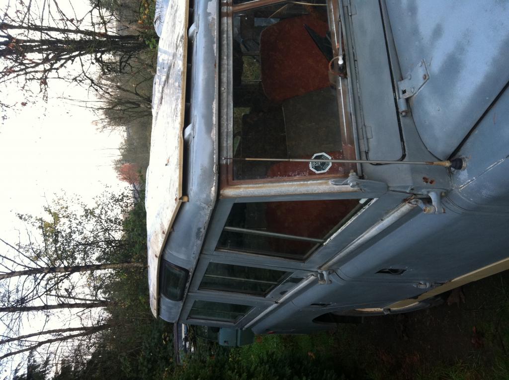

    The rover is super straight. Body is almost perfect. The paint has a nice patina. The interior is 7 out of 10. The head liner is 10 out of 10. It has a factory installed oil cooler. It has a factory installed winch. Tropical roof. It's been converted to run with an alternator. Some sort of unique heater that looks factory (not kodiak). Has power brakes.
    Now the BAD.

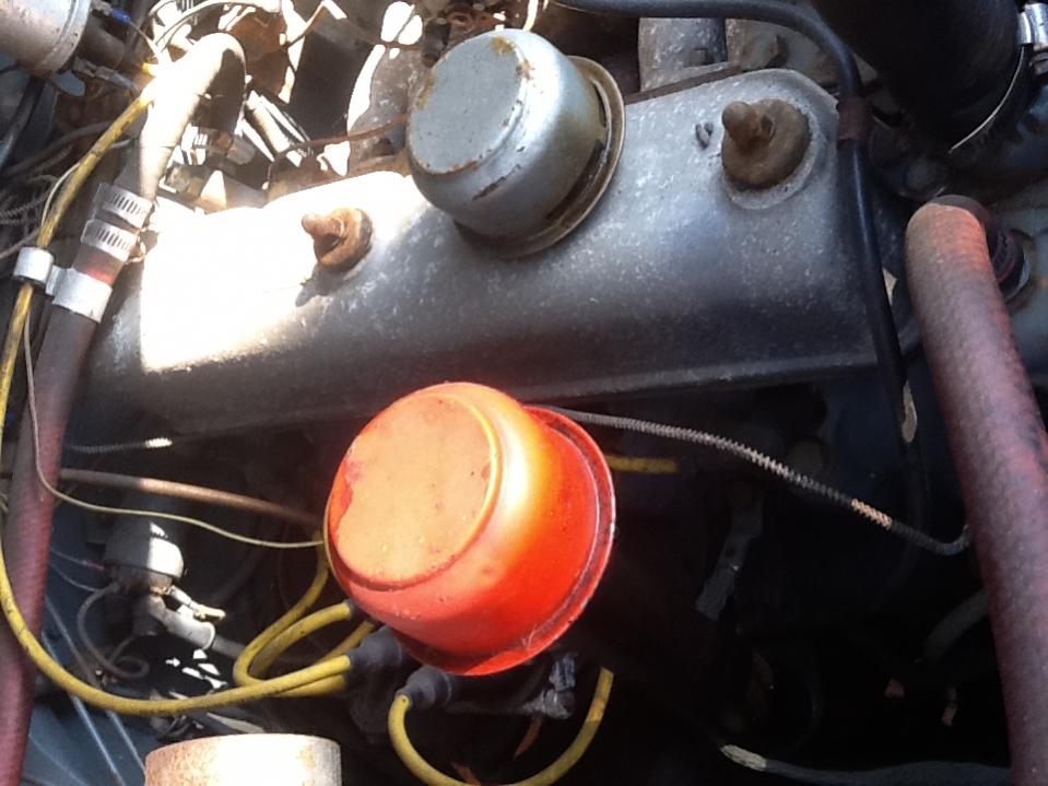

    1. The engine does not run, but it turns over by hand.
    2. Rear cross member and rear portion of the frame to the outriggers is rusted. It will need some work back there, but could probably wait a while. Rest of the frame tings with a hammer and looks good.
    2. The lower rear door frame on the body is rusted.
    3. The lower outer bulkhead door pillars below the hinge are rusted on both sides. Floor pans outside and inside look solid though.

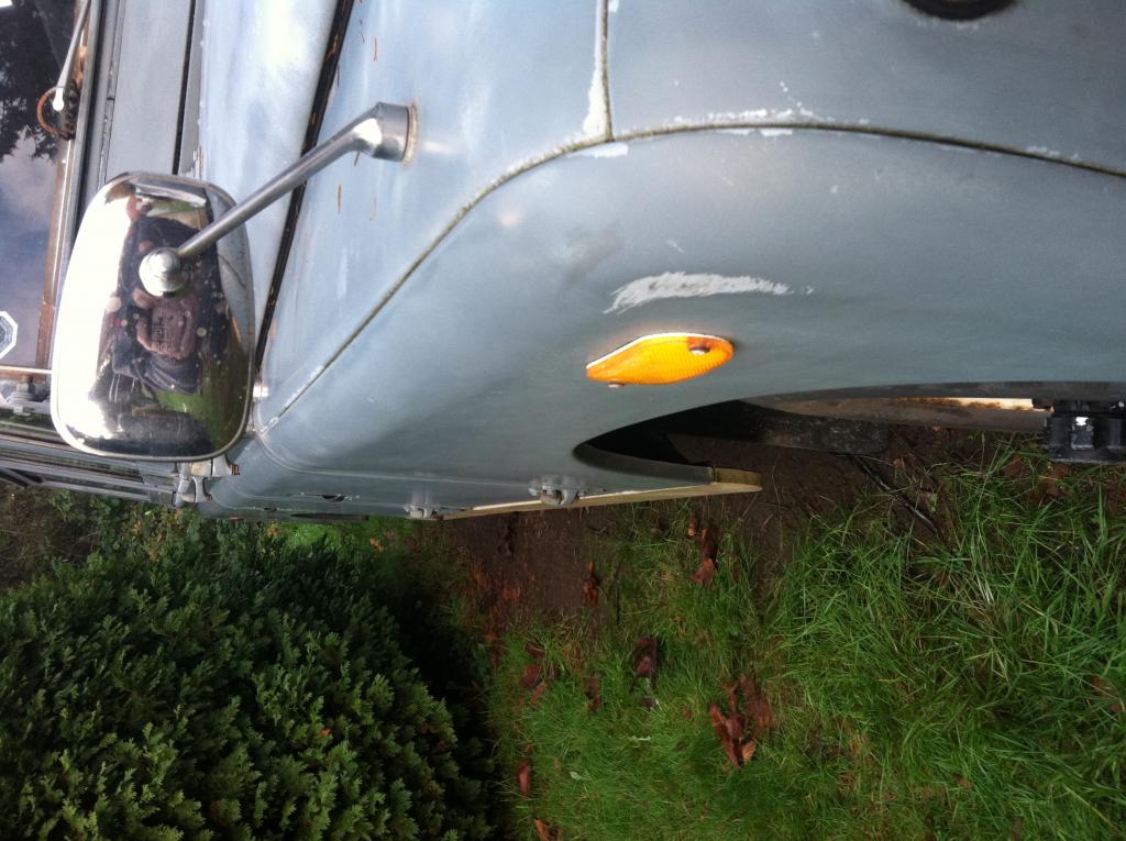

    4. There is a spot of rust to the left of and below the outer vent on the passenger side. It's a weird spot, but rust outside has def come from inside somewhere.
    So my questions to you all:
    1. Am I a fool? It's $4k for this truck.
    2. What could I be looking at to get it running, any thoughts or experience with a car sitting for 17yrs?
    My thought is tackle this in 2 phases.
    Phase 1: Get it running
    Phase 2: Take care of cosmetics ie rust...
    Check out the pics. Look at how flush those doors sit!! Any insights would be greatly appreciated.

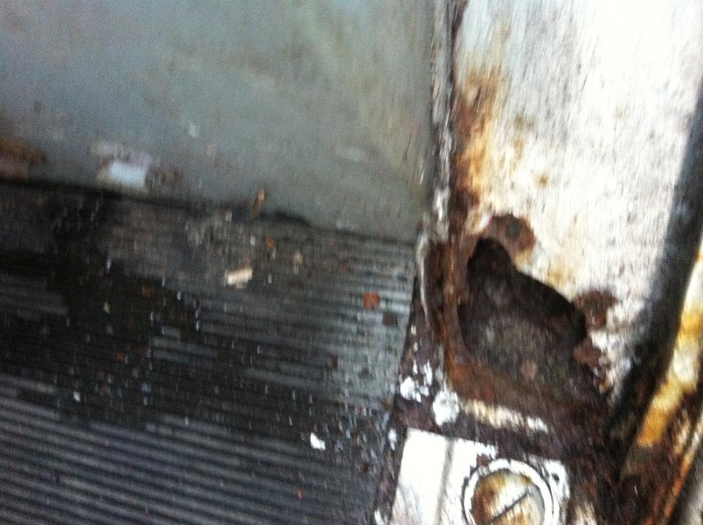

    Heres a pic of the rust on the rear door frame on the body. Pretty much the same on both sides. Click image for larger version

      Do you own a MIG welder?
      If there's enough good metal to make it worth repairing each of those things (bulkhead, t-posts, rear crossmember and outriggers) then it's a decent deal IMO. If you must REPLACE that stuff, then It'd be a tough call if you ask me, but then again, I'm a cheap SOB.
      On the other hand, anybody in the high-quality restoration business would probably snap up a nice, straight $4k 109.

            Add a zero to that and you'll be in the right ballpark for restoring a 2A. They are extremely difficult to find parts for.
            If you just want to make it a driver then of course it willl cost far less.
            Thing is if the rear crossmember is shot that means the rest of the chassis is in question. Rusty doors can be repaired. There are places out there making reproduction parts that will fit, but don't look like 2A bits.

                        At a minimum you have to:
                        drain gastank, clean carb, get engine running. Hope the tank is still good.
                        replace brake lines, replace clutch lines, get these systems running.
                        change all fluids.
                        Get all lights working.
                        Tires?
                        At that point you can enjoy it if the frame is road worthy and the driveline is in good working condition. Expect lots of leaks.. If the frame is unsafe, then it's a big job of removing the top and tub and then hacking/welding the frame back together. Repairing brakes, tuning engine etc is doable for most any shadetree mechanic. Getting into stripping a 109 and working on the frame puts it into another category in terms of space needed, equipment needed, and overall energy levels.
                        Overall though, for 4k, that's not too bad of a job list and nothing there is so NLA that it'll stop you. Solid straight 109's for 4k do not pop up often! If you want a cool truck to have fun in then I'd say go for it. If you want it to be perfect, then you're way better off hunting one down that has already been gone through.
