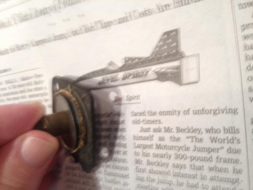

                            Whether or not it is THE issue it does have issues . . .
                            maybe I am thinking about it wrong but if it's the job of the accelerator pump to squirt fuel down the throat of the carb and the truck starts well after pouring some fuel down the carb then I see a connection. Thank you for all the help - I hope I won't need more for this issue after I try this fix!
