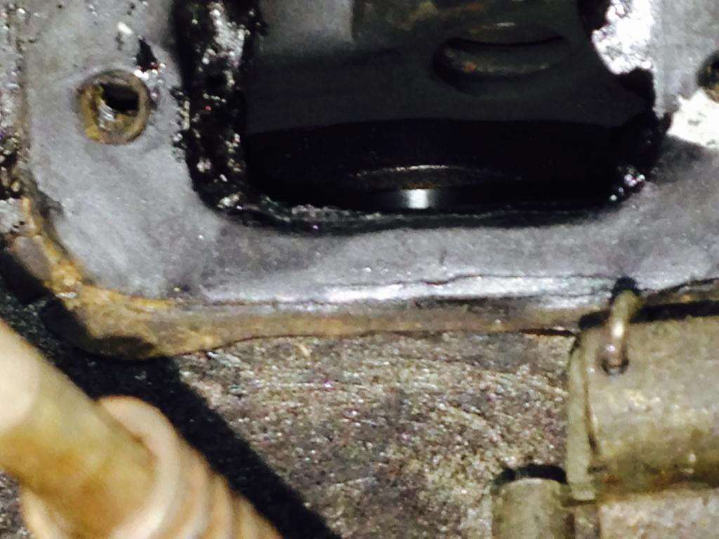

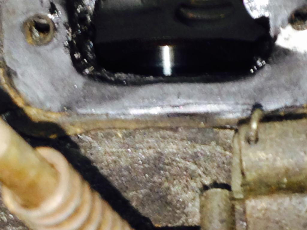

I replaced clutch Mc and SC after having leak in MC. Now I can not get the clutch to engage in any gear. Rover on blocks and I can rotate engine by hand crank with shifter in gear and OD and transfer case in gear but no wheels spin. Same when engine running. Looked down through fill port on top of gear box behind shifter with engine running and shifter in gear but I do not see any gears moving .
No noise either except for the click as you go past indents of shifter. Like the clutch plate is completely gone.
Anyone ever come across this before?
Is there anyway to get my eyes on clutch plate without pulling transmission back like by removing an access panel?
