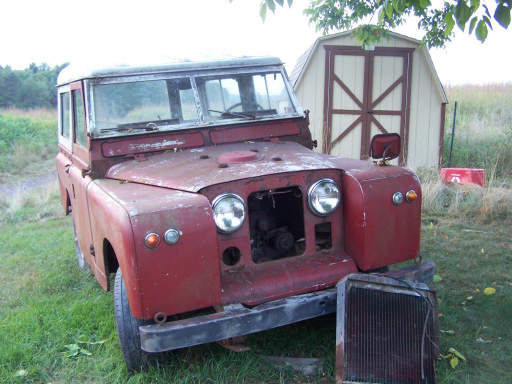

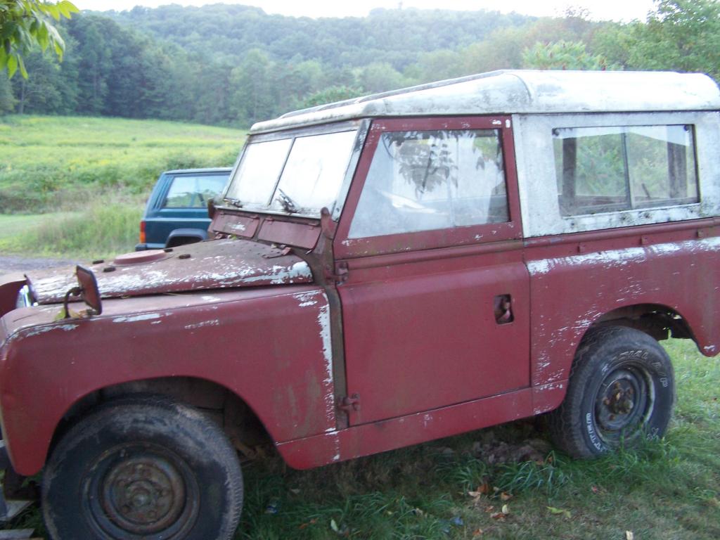

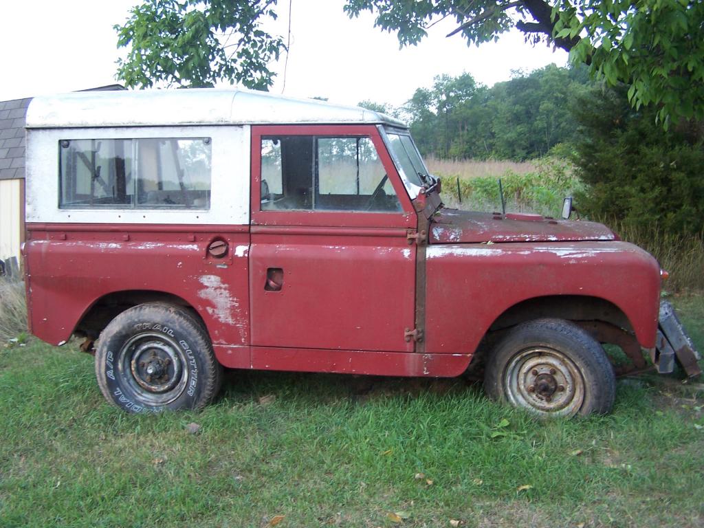

Hi everyone! I'm in the midst of doing a full restoration on a 1966 Series IIA 88 with a 2.25 petrol engine. To make a long story short this Land Rover was given to a friend of mines father roughly 14 years ago as a beater truck to use on his property. When my friend and I were 12-13 years old we used to have a blast taking the rover out on the farm roads and driving it back into the fields to go sledding in the winter. One day the battery died and there it sat until roughly a year ago when I purchased it from my friends father and decided to try to do something with it. Here are a few photos of it after we drug it out of the woods. When I pulled the rover out of the hedge row it had been sitting in for 13 years I found that the engine had seized due to corrosion on the pistons so I did a full teardown and rebuilt the engine with new pistons and bearings. I'm at the point where I have the engine almost back together but the timing has me stumped.
