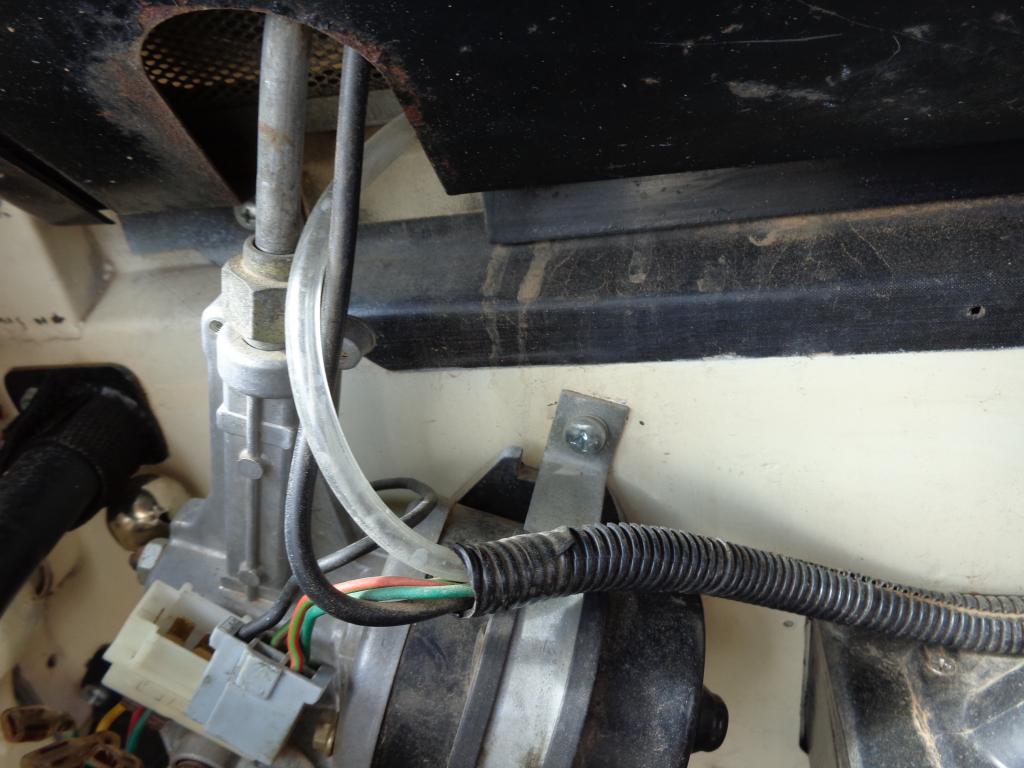

    How do I take off the wiper motor to replace with a new one? (1972 SIII). There is the motor but I don't know how to remove the metal cord (?) that goes to the actual wipers, and yes, i know I don't have the right words but my brain is farting out on me. Thanks!

    Looks like you've got to remove the wiper arms (so the wiper spindles can spin all the way around), and pull the inner cable out along with the motor assembly during removal:

      To swap the cable off the old motor to the new one, you'll have to remove the cover on the back of the drive housing (well, the "front", really). Here's the motor overhaul instructions:

            I was thinking just the opposite--If I had known it was this easy, I would have removed it and cleaned/lubed my cable a long time ago. I thought you had to take off the upper dash and remove the wiper spindle wheelboxes also, which would have been a HUGE PITA.
            As it is, you just pull the wiper arms off and yank the cable through.

                  My 1970 IIA has the same setup - I took the whole thing apart, cleaned / lubed all the bits, and reassembled. Very simple operation, and I am certainly no master mechanic.

                      It is not as hard as it looks, the nut(#5 marks first post) holding the cable in place on the top needs to be loose to turn the motor to access the cover plate. In Marks second post you can see right by the #7 to the right is the cable end which goes over the stud on #4. The biggest thing in reassembly is having the #4 in the same position as the wipers otherwise the cable will appear too short/long. You might as well clean out the old grease and put in some new. I used Phil Wood bicycle grease in mine. HTH

                            If you mean the ones I posted at the beginning of this thread, I just took them right out of the SIII Workshop Manual (NOT the "Haynes" thing!). Electrical section, I think.
                            Originally posted by siii8873
                            Mark, SIII set up is much more difficult to get at the boxes due to the dash arrangement. SII's are much easier to get at the parts.
                            True, but I don't believe you really have to get at the wheelboxes to remove/reinstall the cable, so long as you remove the wiper arms, if I'm understanding the instructions correctly.
