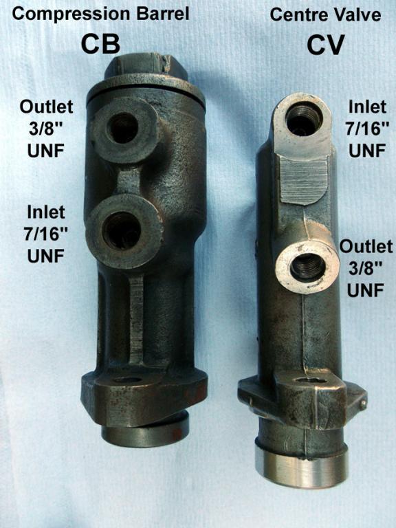

I just installed a new CB brake master and CV clutch master in my 62' 109" and I can't figure out the size of the outlet ports. The input side (from the brake fluid can) for both is 7/16 - 20 . The outlet side, to the brakes or clutch, isn't 3/8 - 24 or 7/16 - 20. Any idea as to what size these are?
Thanks.
