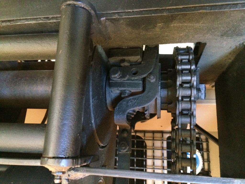

        I found the Series 2 in about 3 ft of bushes. It had been there for many, many years and the winch and huge bull bar bumper w 2 jerry can holders was original so I took it apart and cleaned it and it works great. The winch didn't have a switch so that is why I was asking how to connect it. i will do a cut off switch as you suggested and mount it like yours. All still a work in progress, but the truck runs amazingly well and have driven it a bit w no brakes or running lights.
        Winch says Jack & Heintz Co. I found JAHCO online it was or is a airplane manufacturer in the UK. Pretty old school so I had to keep it.

          That's a very interesting winch. Do you have more photos?
          I am confident that someone hand-built this one, but I could be off the mark. The motor and attached planetary drive look to be aviation-grade.

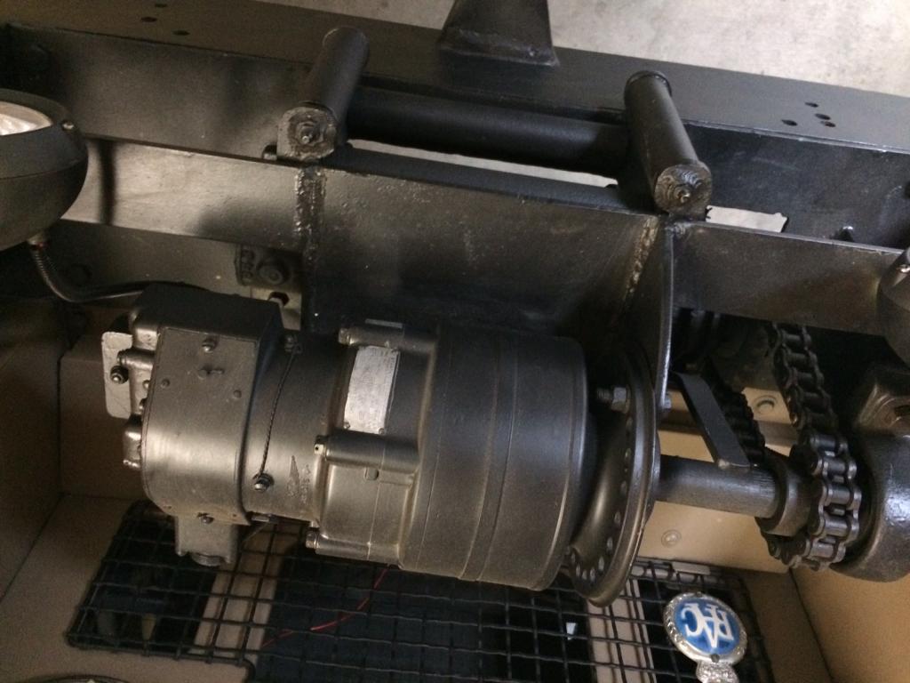

            I will take a few more, but I suck as as photographer and they always seem to download upside down. There is a lever that allows it to turn freely so that you can pull out the cable. Once engaged the motor pulls well. A friend gave me a new metal cable so I will use that for now. The entire brush bar, winch and jerry can holder looks hand made and very beefy. I wonder if it was used as some kind of tow vehicle.

              Here is another pic of the winch. The lever takes it in and out of gear. Pulls strong.
              Okay, I did not stand on my head for the pic but they always upload upside down sorry.
