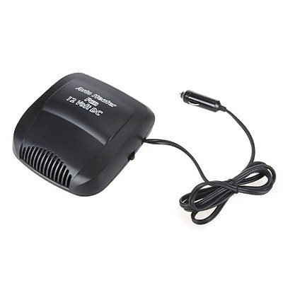

    Has anyone tried this little unit in their Series truck to defrost their windshield? It comes in at under $20, and might be worth a try.
    Keep your car warm and comfortable with our range of 12V DC portable heaters, including the 800W Electric Car Heater. Shop now on eBay!
    This year's winter has Upstate NY in quite a cold snap. My breath is fogging the windshield and my heater/defroster is woefully inadequate. My dashboard is so Swiss cheesy that little heat is making it to any of the vents, and I'm starting my search for alternatives to get me through til Spring.

    I have not tried that product. Anything I have tried that plugs into the cig lighter though has always been crap. To do much of any good I think you would need higher gauge wiring going to your cig lighter.
