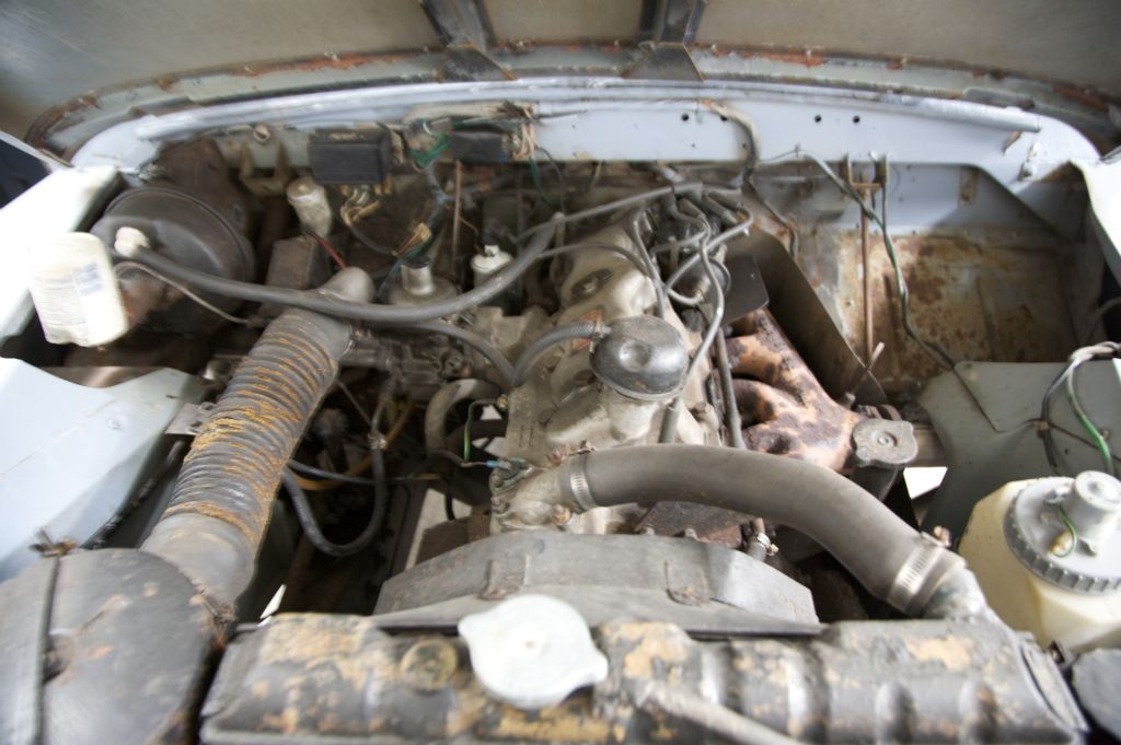

    Below is a picture of my current radiator
Name:	photo 2 (1).jpg
    Here is the replacement radiator
    What is your views: RN is checking to see if the right one was shipped to them. Theirs looks very correct to the picture on there site.
    1) Will this keep the engine cool enough?
    2) Is this a correct replacement?
    3) Does any one have a picture of there original radiator to compare too?
    thanks
    josh

    That looks a pretty much the same as the radiator that came with my '73 109 with an Euro-spec 2.6, though my top hose connection was short and straight and not bent like that. Mine is a 4-row radiator.

      Replacement parts nowadays are never as good as original. Quite often, they are useless fakes (like your radiator). Not the fault of the vendors, it's the suppliers.
      If it were me, I'd have the original re-cored at a good radiator shop. It will keep the original dimensions and appearance.

          The original brass top rads. were discontinued many years ago.
          As with a lot of parts on older vehicles, not just Landrovers, compromises have to be made. The ones RN currently sell, is the style used on the later IIa's and Series III's (same as factory specs.) . If you are concerned with originality, the best course of action would be to have the original rad. recored (as suggestion above). The PLC513 Rads. that RN currently sell perform well on both early and late Landrovers.

            Years ago I bought a replacement radiator for my 65 109 that looked just like the one you have. I needed a different top hose because of the difference. I also - when I had the time - took my original radiator to be recored to keep as a spare and to be able to go back to the original if I chose to.
            I never had an overheating issue with either radiator and it worked great. That being said, the fins rusted on that radiator quicker. Not overnight but within a few years - and I was in San Diego at the time . . .
            So now I just swap out the radiators if and when I need to.

              Thanks for the great feed back.
              The plan is to replace next Tuesday...
              Then repair the old one. This one has over heated, at one time, as you may be able to see that the top of the radiator is pushed up

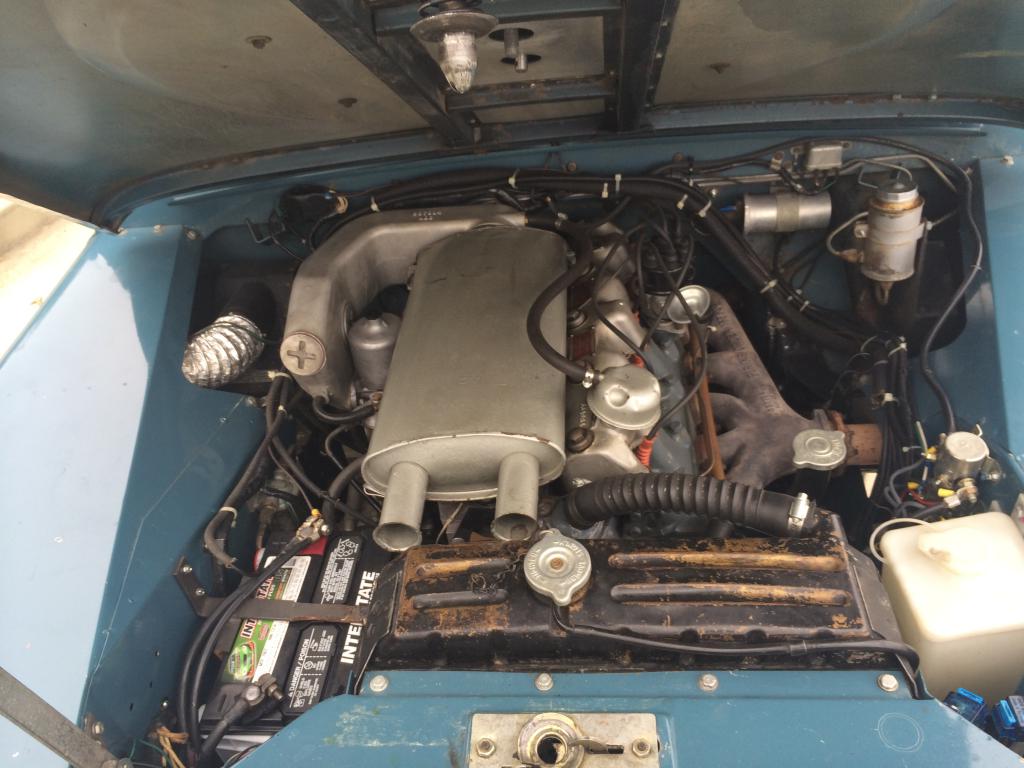

                    I have a Euro spec 6 in my 109 and I can take pictures tonight if you still need them. I will also be driving her to work tomorrow so if you do not get this until then no worries. Could always step out and take a picture if it helps. I doubt they had two different rads for the 6 cylinders when your head is the only real difference????

                      How would one tell if we have a Euro head or the Westlake on are 6 cyl engines?
                        I believe the muffler style air intake and the fact yours was a NADA model. Mine was imported and is right hand drive. Hope it helps.
