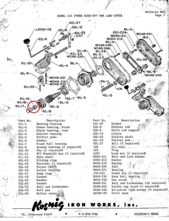

My truck has a Koenig winch driven by the PTO. There is a needle bearing which fits on the end of the main shaft and fits in the PTO. Mine is shredded. Any idea where to source the needle bearing?
THX.
