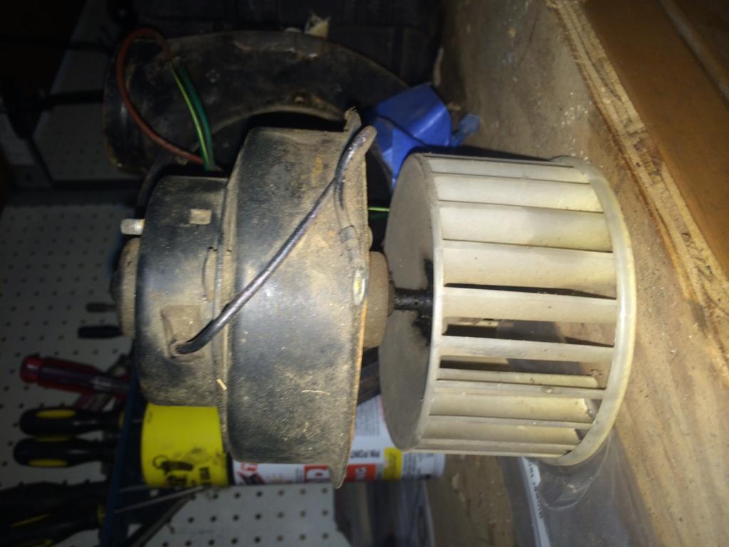

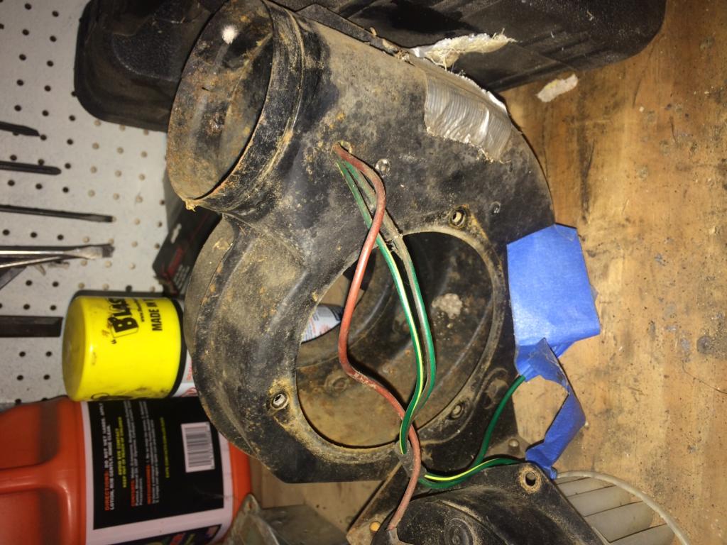

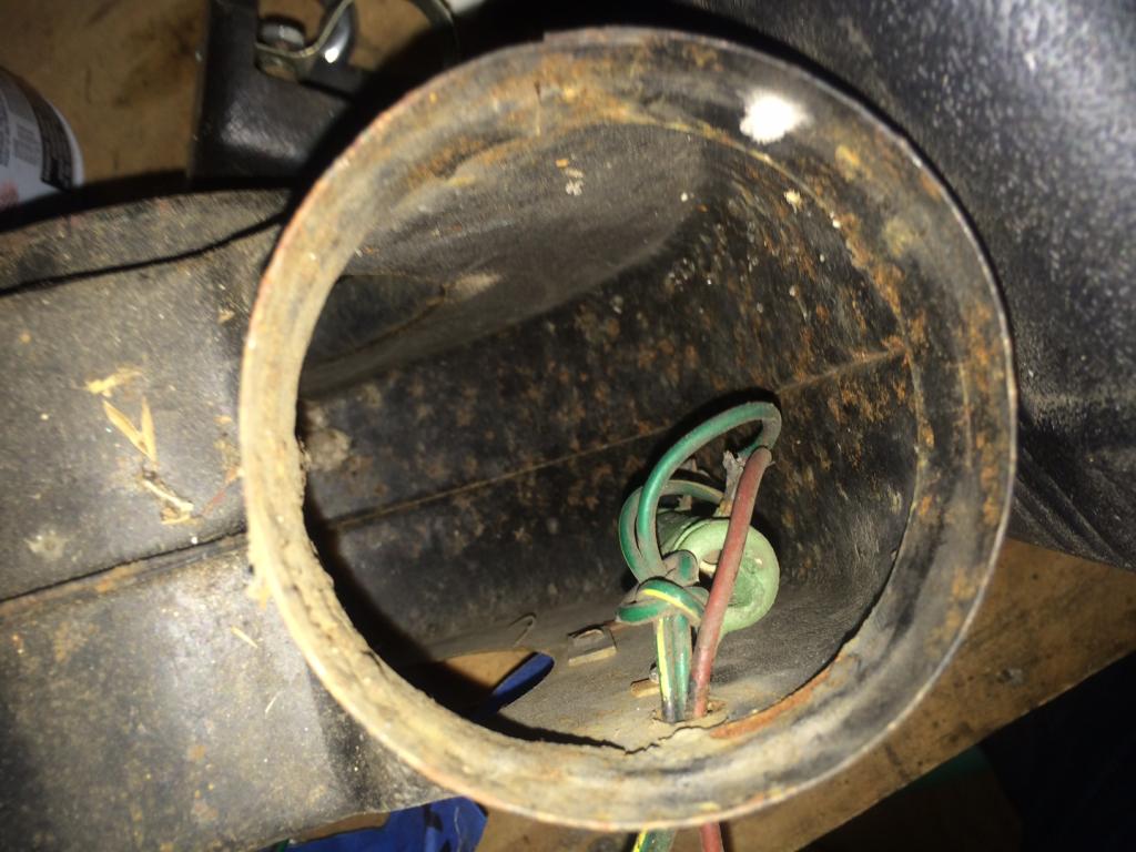

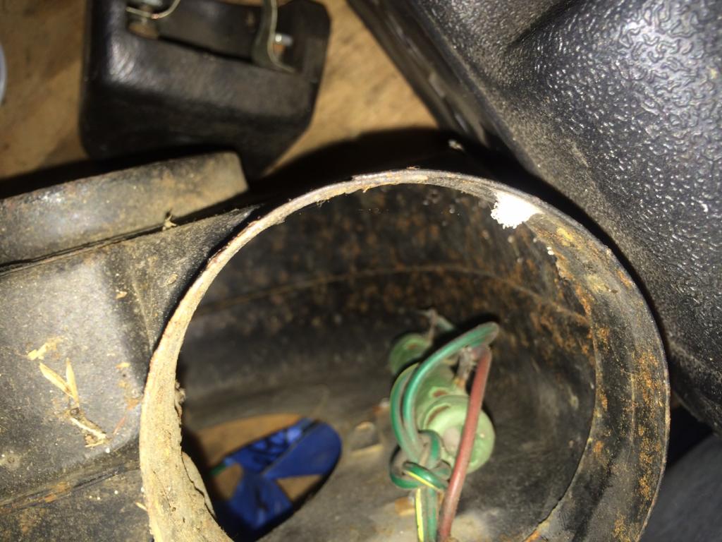

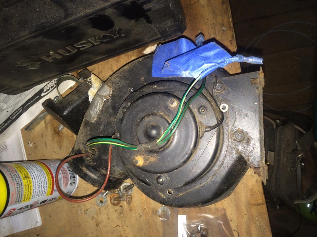

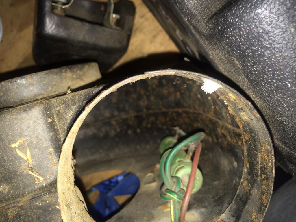

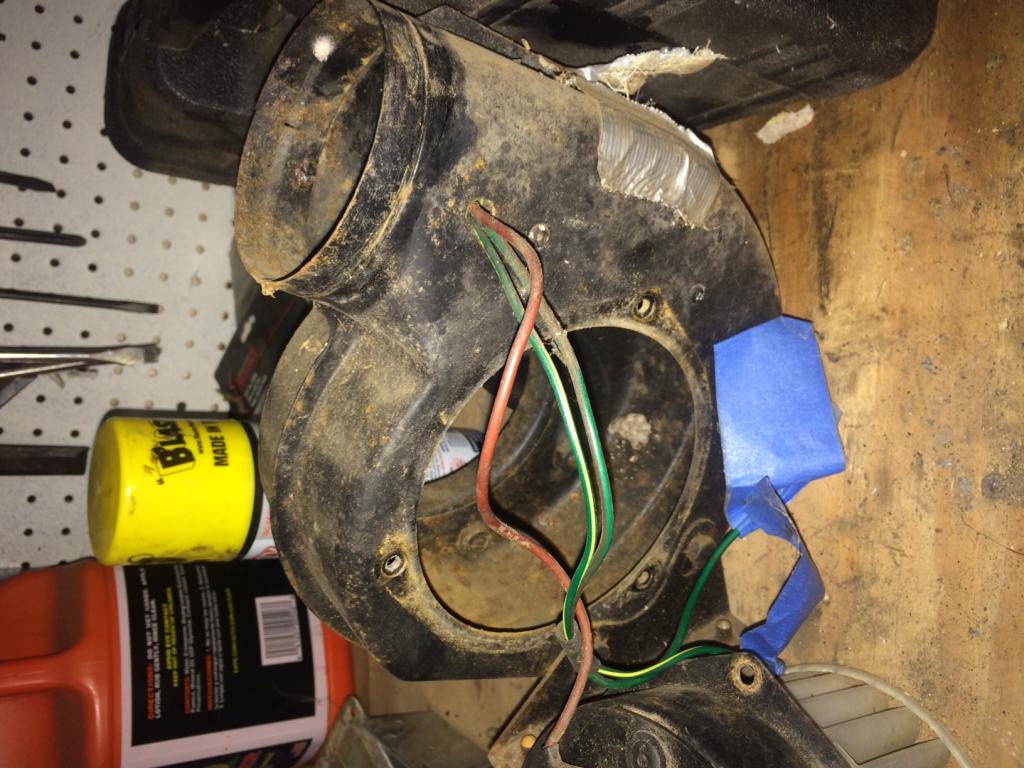

    Hi, all!
    This is my first post on here and it is regarding the blower motor on my Series III. I tested the electrical connection and everything is A-OK. But still the motor doesn't run, and I'm wondering if it is possible to repair or if I just need to replace it entirely. If it is repairable, please let me know how!
    Thanks!

    That's a two speed blower. The way it works is that the Green/Yellow wire runs power through a coil resistor (you can see it inside the blower) and then to the brown line supplying power to the motor. The green/brown wire is a direct tie into the brown line - which (as mentioned) runs power to the blower. The green/brown and green/yellow wires run to a three position switch (off, low, high) that runs power through one of the two wires to the blower.
    With the switch to high, the green/brown wire is the source of power and bypasses the resistor, giving full power directly to the blower. With the switch on low, the green/yellow wire is the source of power and it runs through the resistor, giving partial power to the blower.
    Points of failure on these blowers are with the resistor (you can only get high power) and with the motor itself. You can test the motor with a 12V battery. Ground the black wire to the battery's negative terminal. Briefly touch the green/brown wire to the battery's positive terminal. You should get high speed. If you get no rotation, the motor needs repair. Briefly touch the green/yellow wire to the battery's positive terminal. You should get a slower speed. If you get no rotation, the resistor needs to be replaced.
    Good blog on repairing these motors here.

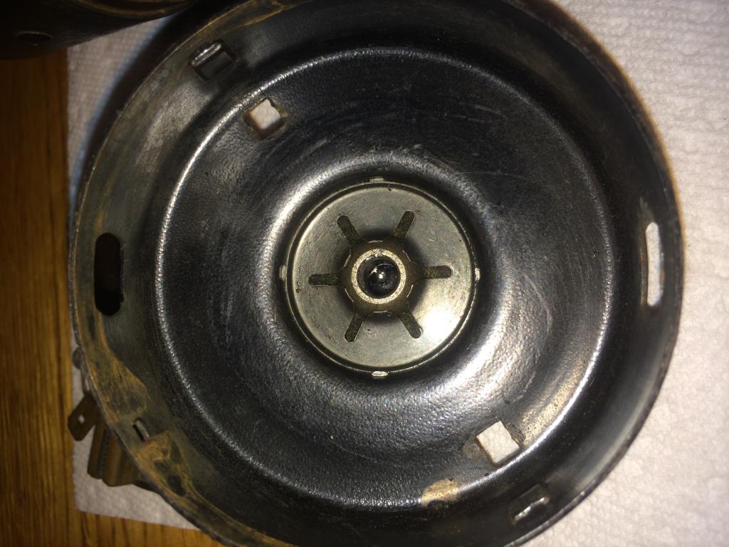

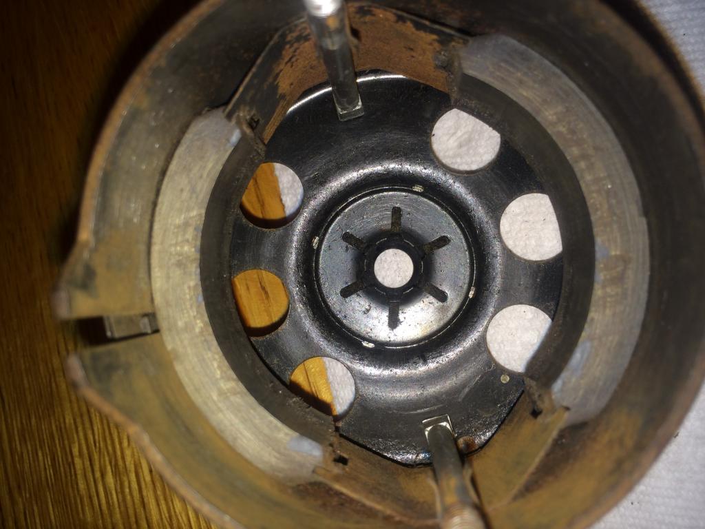

                        So I'm in the process of restoring the motor and I need some advice as to how the heck to remove these plates that contain the bearings so that I can clean them. The first photo is that of the end cap for the motor casing. And the second photo is of the other half of the casing which the shaft runs through.Click image for larger version
ID:	169230Click image for larger version
                        Thanks again for all the help!

                          #13
                          A couple thoughts:
                          1) Reach out to the guy that writes the blog I linked to and ask him for advice.
                          2) Those bearings look like closed units and may not be meant to come apart (blog guy can help there since he was able to get his out). You may consider trying to just pull out the bearing as a unit to soak in gas or replace with a new bearing altogether.
                          3) if the bearings aren't siezed, try cleaning them in place by soaking them in gas letting them dry and relubricating with a bearing oil.
