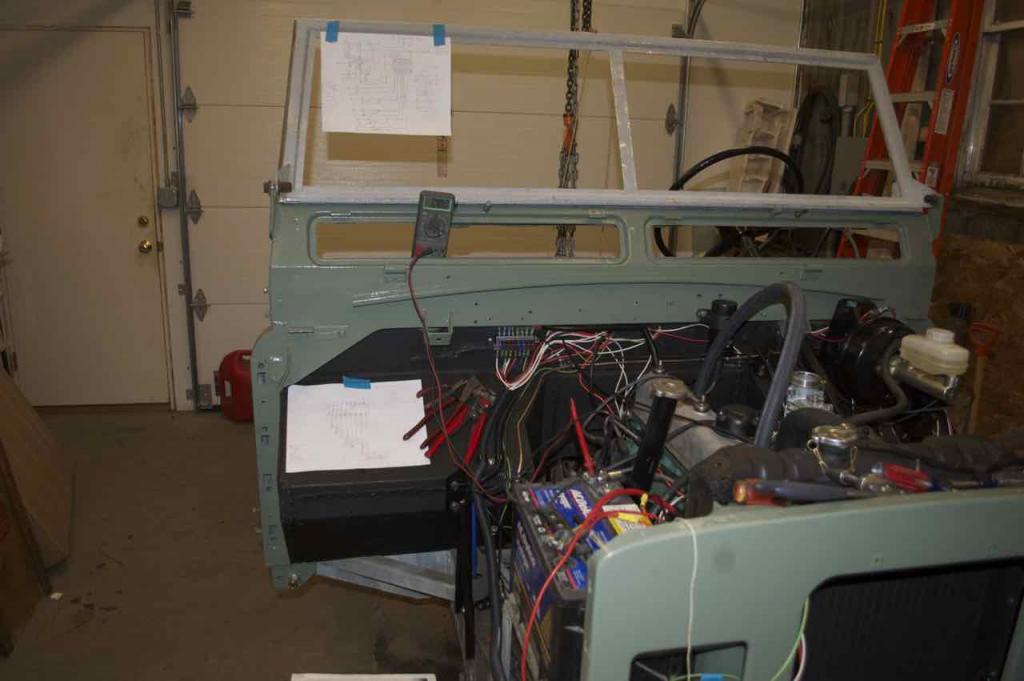

        Very good advice from Teriann. I did nearly everything she recommends when I built my own harness . Drawing on what I learned from rewiring my sailboat it was a fairly simple process. I printed out a the original wiring diagram which is taped to the windshield then redrew portions of the diagram to accommodate a fuse for each circuit. That's the diagram taped to the foot well. Upgrading to a Delco alternator and a modern starter freed up a lot of real estate on the bulkhead. It eliminated the need for a stand alone solenoid and voltage regulator leaving room for a larger fuse block. The local source in Portland, Maine supplies many marine related businesses so he only stocks marine grade (tinned) wire which I believe is well worth the additional expense. Here are a couple photos, one partway in to the process and the second when it was nearly complete.

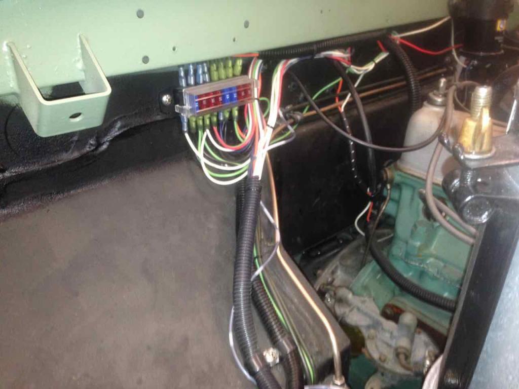

                          Listen to Terriann and O2batsea when it comes to cost and how to do it. I'm currently building a new wiring harness for my daily driver, but the way I'm doing it, is I measured the truck up, and mocked the engine compartment and dash area up with peg board, the type you hang your tools on. I'm going by the diagrams in the book, and referring back to my truck for anything that doesn't seem to match up. One thing that I'll mention getting that no-one else mentioned yet are heat shrink connectors, these are great as they also give you weather proof connections on your wire ends. When I'm done, I'll have a wire harness that matches the British standard color codes that can just be dropped it, with a new multicircuit fuse box and relays for the headlights. As for the gauge and sizes of the wires, I believe Terriann has that in her website if I'm not mistaken.
