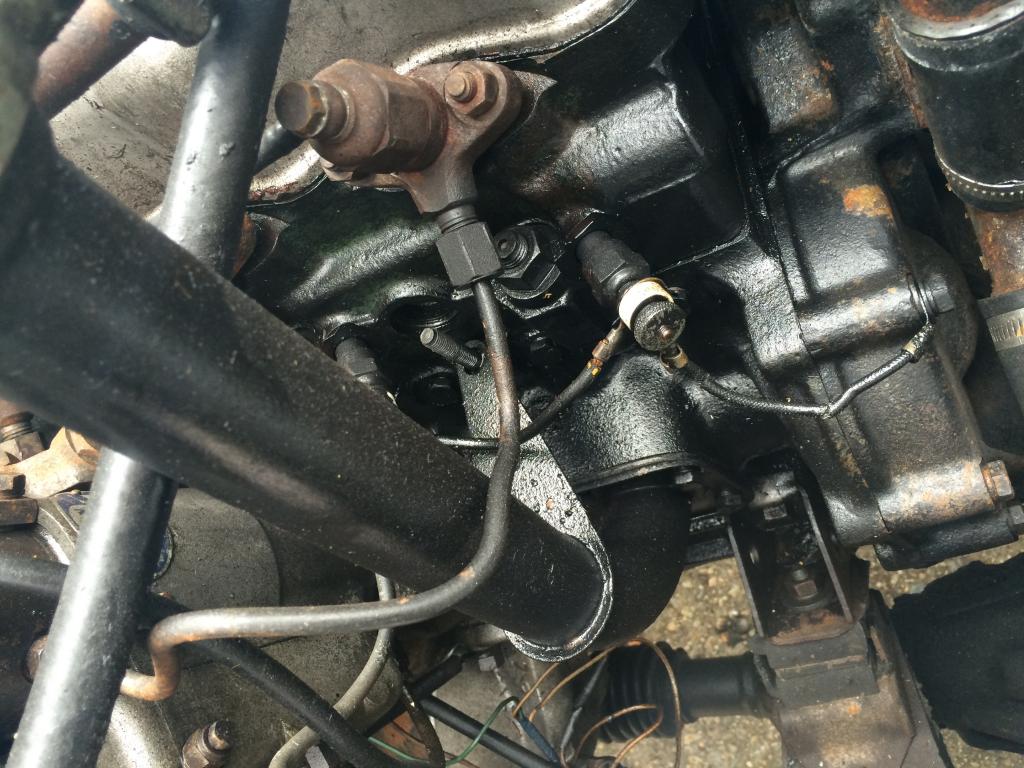

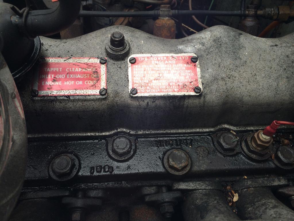

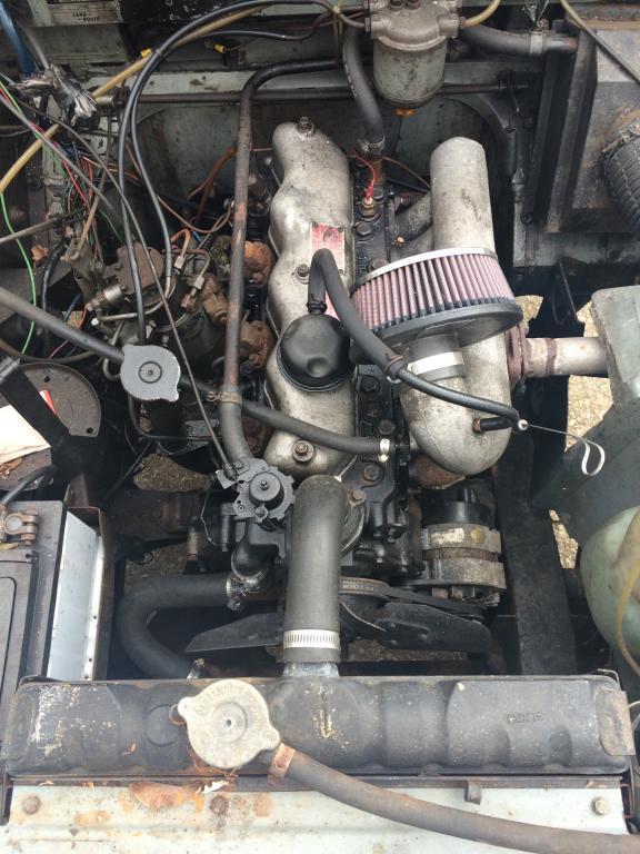

ID:	169240Click image for larger version
ID:	169241Click image for larger version
ID:	169242Click image for larger version
                      here ya go.
                      so full engine compartment view
                      down below the oil fill tube, where there is a build up of oil
                      Top of motor, right side, more oil
                      Again, forward lower left, more oil

                        To me, it looks like your typical valve cover leakage. In fact, I'd be happy if mine looked that nice.
                        Using the old "trial and error" method, you may be able to clear up much of the smoking by adjusting the injector pump timing. Just need to find that sweet spot between smoking and knocking.
                        --Mark
                        1973 SIII 109 RHD 2.5NA Diesel
                        0-54mph in just under 11.5 minutes
                        (9.7 minutes now that she's a 3-door).

                              Clean ! The HRC # would usually mean it's an early 2.25 Defender head, though it's interesting it has the early style glow plugs in it.
