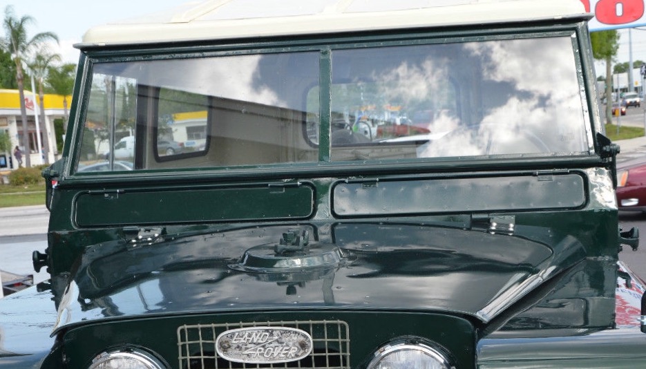

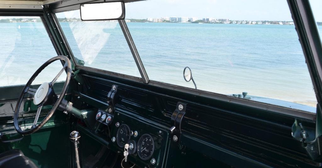

          Thank you for the feedback and the advice. I don't want to hack up my 2A, I just need to install some windshield wipers. One of the previous owners removed them and I'm just looking for the best option and as you can see from the pictures I have nothing to work with. Either way I'll be doing some drilling and I thought I would be easier to drill one hole below each window instead of 3 holes through each window frame.

              Don't drill your windscreen. I'll send you a windscreen that has the holes if you pay shipping.
              PS There's some good Rover chrome under all that paint. That's one project that won't cost much and will HUGELY improve the look of the truck...that is to strip the paint and regalvanized the parts.

                Thanks! I will take you up on that offer. Does the glass come out easily? I can't figure out why someone would have done away with the wipers, sunny day driver? This is a Land Rover! I was thinking that I would take some of the paint off the trim around the rear and corners. I'll probably drive it for the summer and see what else pops up, I'm sure something will need attention. I actually live in CT, the 2A is coming from Tampa.

                    If I were to venture a guess, I'd say that the windshield frame came from a Rover with a single wiper motor system and the bulkhead belongs to a rover that originally had two individual wipers in the windshield frame. Lots of part interchangeability over the different series.
