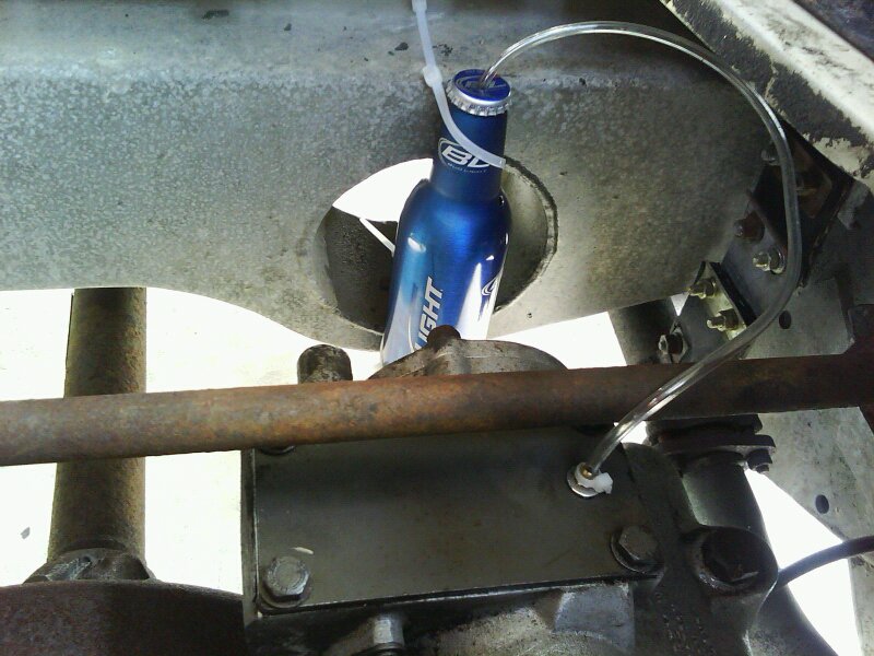

        I check and top off my overdrive every two weeks when I drive my Series regularly and I had the same problem with the overflow leaking out of the breather and spraying the rear axle and sometimes the tailgate with oil so I added an overflow reservoir. I would have used a British beer bottle but was unable to find one in an aluminum bottle.
Name:	Fairey Beer Can.jpg

              My OD is always overfilled - I am told that it is because of oil from the t-case leaking into the OD. I tapped in a breather like Manny's, but just ran it into the frame. No more mess! Been this way for years with no problems.

                Well, I like the approach of Manny's overfill bottle, with a minor deviation. You already pointed out one extremely serious issue with it being a Budweiser product. I'm going to go with plastic so I can see inside more easily. We typically accumulate an abundance of Gatorade jugs around the house which should be sturdy enough and fit the bill.
