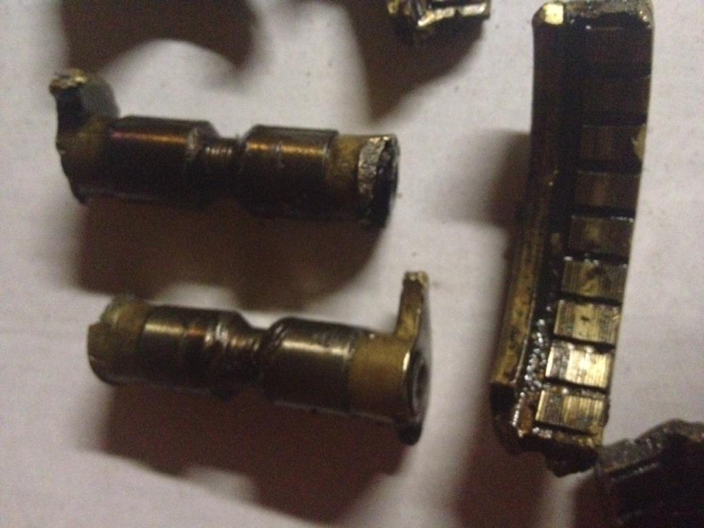

    I wanted to replace the transmission, and transfer box fluids in my 61 109 Station wagon before I install the freshly painted seat box. When draining the gearbox, metal chunks came out, and I put my finger in the drain hole and felt more metal chunks. Is there a particular part that commonly breaks in these? What am I in for as far as repair? I'm doing a frame off refurbishment, and I have complete access to the transmission and transfer box.
    Incidentally, when draining the transfer box, ATF came out.

    Are the chunks steel or brass? Flat (like a shim) or do they have more mass?
    Pics?

      They were pretty substantial chunks. Not sure if they are brass or steel. I will check.

        All brass chunks. A few pieces look like they could be clutch pieces of some sort, and the other pieces were shafts that had a rotating part in the middle like a bearing. I looked in my workshop manual, but couldn't find any pieces similar.

          Do you have a pic of the debris?

            Here you go. Seems like something catastrophic happened.Click image for larger version

              Wow. No problems detected when driving?

                Yes. Wow.
                That's a COMPLETE synchronizer unit that's been destroyed there.

                  I've never driven the truck. I bought it 10 years ago, and immediately started the tear down. It wasn't running when I bought it.

                          I know of a couple good used transmissions. I wouldn't fool with that one.

                              Like the others have said you lost the syncro minimally. Just tear it down and see what else is messed up before making any decisions.
                              I had to rebuild my transmission earlier this year. Below is the thread on that. Honestly it is not that difficult of a job. Since you are doing a frame off restoration I would just do it rather than getting another tranny that may or may not have its' own problems. You can rent a hoist for $40 or so. The parts for my rebuild was around $1000 (all new bearings, couple of shafts, some gears).
