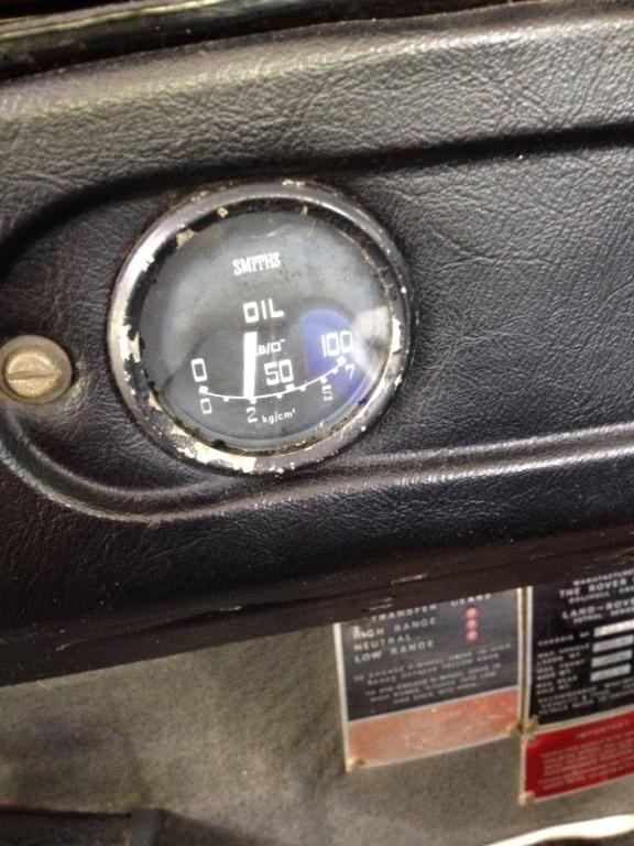

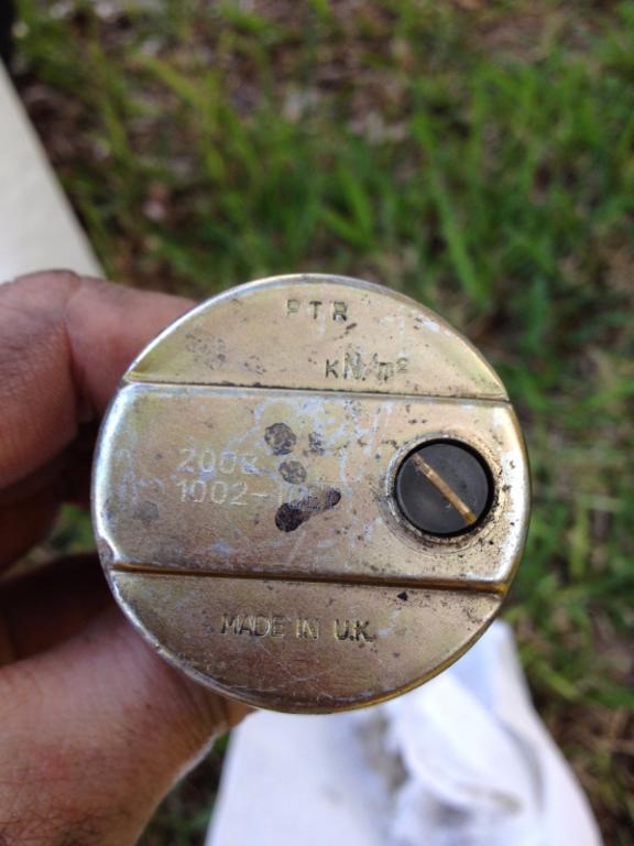

    Hello...
    New owner of a 1972 Series 3.... Was wondering if anyone knew if I have the correct combination of Oil Pressure Gauge and Sending unit. Its the Electric style.
    On the Gauge it says Kg/Cm2 & LB/0"
    The Sending Unit says kN/M2
    My Rover never seems to register over 25-30lbs of oil pressure.... Just wondering if my gauge combination is correct, I believe at least the sending unit was replaced at one point. I think the Gauge is original to the car though.
    thanks in advance!
    -SeanClick image for larger version

    This should help: http://www.robertodecarlo.it/mercati.../catalogo1.JPG
    If you lookup the sender on Rovers North: http://www.roversnorth.com/ProductDe...e=0&eq=&key=it
    Zoom into the image and it looks to have the same print on it. Looks like a match to me.
