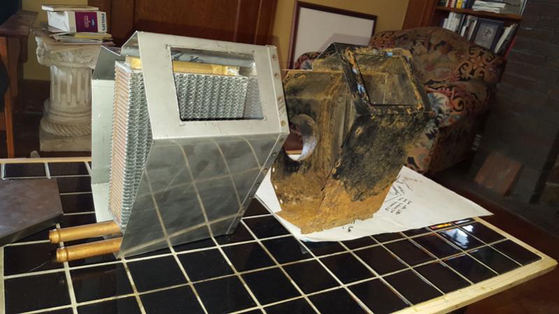

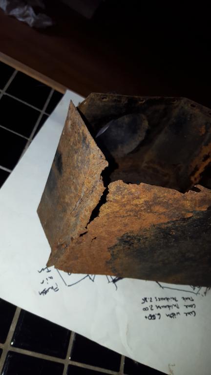

As illustrated in the pics, my heater box on my daily driver 72 88" was pretty rough. Probably repairable, but since I have no reason to keep the old box (eg: obsessive originality syndrome), and I Know a Guy, I went a different direction. And I'm posting here as proof of concept.

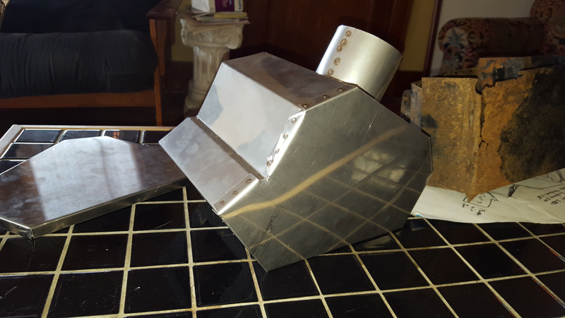

Using the old box, and some measured drawings, a sheet-metal-worker buddy of mine fabbed me up a box in stainless. Took him about an hour and a half. My guess is it would cost around $150 to get something similar knocked together. In my case it cost some as-yet-unprocured hard-to-find microbrews (anyone wanna ship me some Dinner, Mean Old Tom, or Heady?) Though, I'd likely have a tough time getting someone to take the job here, if I didn't know someone, since the bigger shops here all seem VERY busy.
I might have to accommodate the different inlet angle so that the hose doesn't interfere with the hood, but I think it will be OK. The hood is easily 3" above that point there.

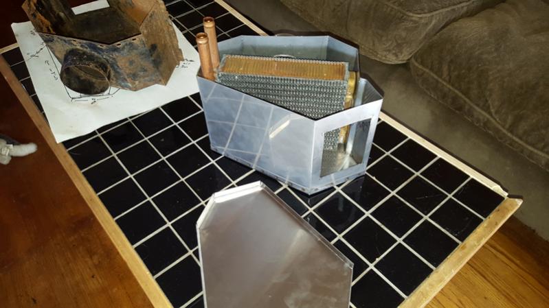

I'm using the common alternate, perfectly fitting (OK, an interference fit) late 70's Ford P/U heater core. $20!
Spectra 399023/94571
Murray 94571
Carquest/ToughOne 399023
So I'll drill out for the tubes, do a little sealing, and I'll just rivet on the "door" - I don't expect to need to get in there for quite a number of years - and I can just drill them out then. And I need to make a mounting tab for the top, and After a quick trip on the wire wheel and some rattlecan, I'll reuse the mounting ears for the sides.
