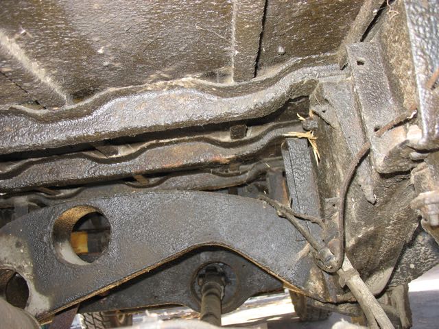

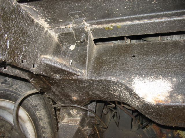

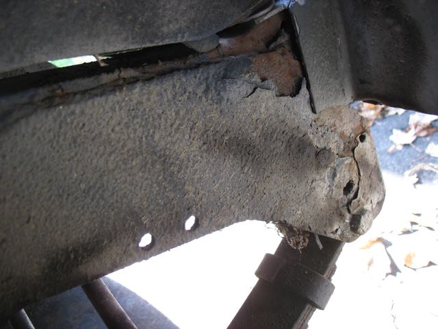

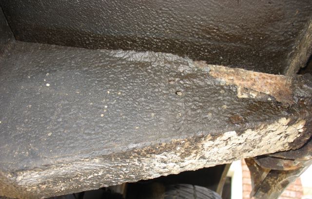

    Hi all,
    I'm looking at a SIII 109 for sale locally. It was a military (MOD) vehicle, and although the frame (and chassis) looked pretty solid on my inspection today, the entire frame, outriggers, and chassis is coated with a thick undercoating which I think was done as part of preparation for the military.
    I attach a couple of pics to show the undercoating and a couple of spots where the undercoating is peeling off revealing some rust underneath.
    My concern about this type of undercoating is that after 30 years it's cracking in places and allowing water to seep in underneath and start rusting the metal. Luckily this LR doesn't seem to have been driven in winter salt in many years.
    I can imagine it would be a royal PITA to remove this undercoating from all the steel members.
    Anyone have experience with this and have any insights to offer? Is it a good or a bad thing for a LR to have this?
    Thanks.

    The military undercoating can be a mixed blessing. From what I have heard it is VERY hard to get off. I left it on mine.
    If you do buy it to keep rust at bay at the spots where it has cracked and peeled I would use waxoil or a similar product. I believe the underseal can hide rust that is more on the inside of the frame. But you may be able to judge that by the overall condition of the frame.

      My experience with Military undercoating, (I have a 2A ex-mod.) Some spots where the coating came of was pristine, I mean I could easily see really clean metal, and then other spots where it was difficult to get the undercoating off, were very rusted, it was like the undercoating kept the water in, and rusted badly. But honestly for the most part, I think it did it's job.
      I did replace my frame with a new military, from our lovely hosts.

        Thanks guys, that's what I had figured but good to get confirmation on it. Mixed blessing indeed.
        Anyway will see how things go, there were other issues with the truck and of course, the price to be negotiated.

          Take a ball peen hammer to any place you may think is hiding rust to see how solid it sounds.
          If the owner is not willing to let you do this, he may be hiding some rust.

            Yeah I crawled underneath and banged quite a few spots on the frame rails, cross members and outriggers, and did not come across any soft spots. I actually used my dad's old prospector hammer, which has a pointed end. So in spite of the spots where the undercoating is peeling off and rust is showing underneath, I figure the undercoating has largely done its job over the years. Still, would be good to regularly waxoyl the INSIDE of an undercoated frame, I would think...

                  leave it on. there's really no point in removing it. the time you would spend stripping it is not worth the labor and frustration. i have a 109 and a NAS 88. the military frame was in much better condition. i attribute it to the military undercoating. as for stripping the paint i don't see how you can remove the paint w/o going to the aluminum. i mixed rustoleum to match the OD paint and brushed it on.
