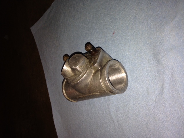

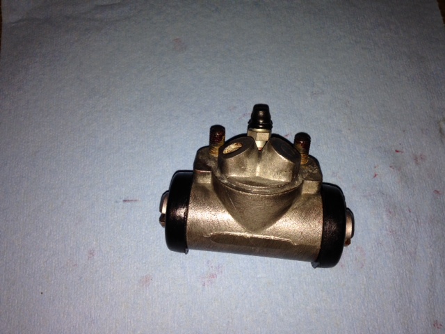

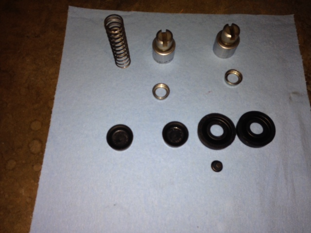

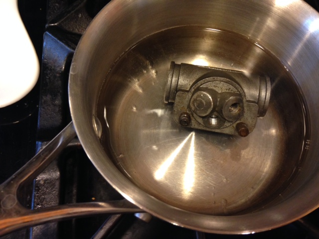

    Brake Cylinders weren't even functioning.... its amazing the beast even stopped.....Never having done this before, I figured I would try. The brake fluid was crystalized and hardened in the cylinder. after removing them and digging them out, I cleaned them up well, boiled them out in some nice cookware, honed out the cylinder, and reassembled.
