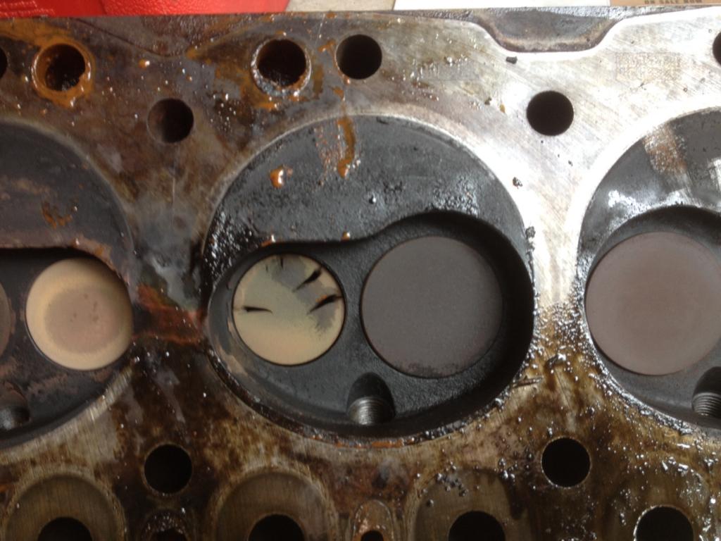

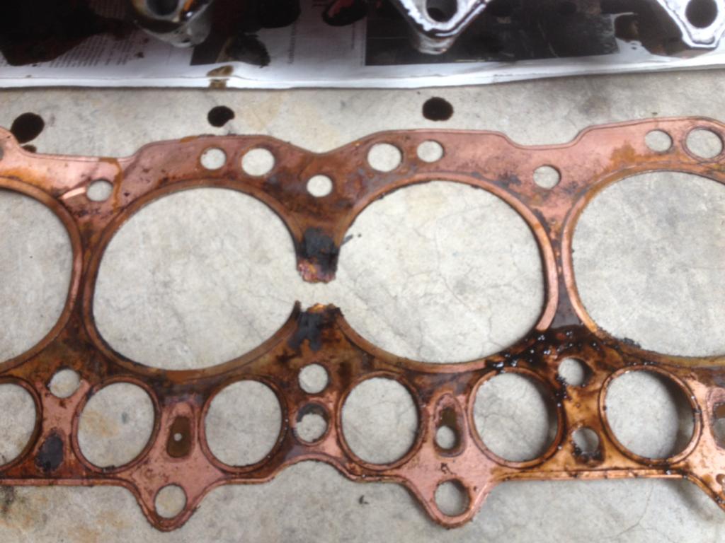

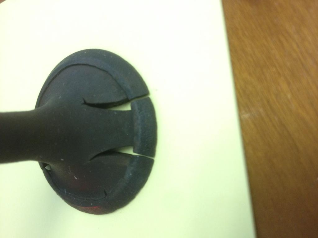

                          Welp. After many attempts I had accepted the fact that Series Rovers were just complete dogs. Then I lost even more power. Tried all the stuff...again...no improvement. Realized I hadn't checked the compression in a while and cylinder #2 now had 40psi and #3 had zero. Well there's the answer. I pulled the head and found:
Name:	blown gasket.jpg
ID:	169487Click image for larger version
Name:	blown valve detail.jpg
ID:	169488Click image for larger version
Name:	blown valve.jpg

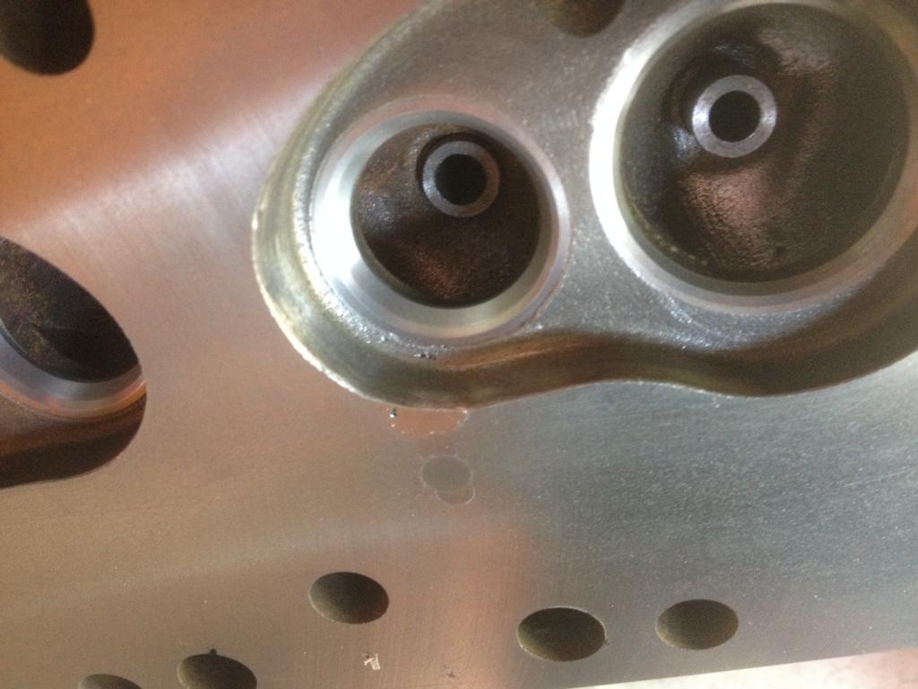

                          Additionally the head was cracked at #3 which let in water or steam vapor which resulted in the weird cracks on the valve.
                          I had a machine shop fix the head, insert seats on the exhaust valves, press in new guides. I reinstalled everything and the truck runs like a striped a$$ ape. I can climb my mountain highway in 4th gear the whole way! So I will say they aren't dogs...they aren't exactly sporty, but now it drives like it was designed.
                          Nearest I can tell the head gasket was blown the entire time I owned the truck, but the valve had not yet failed. Compression was fine, but little did I know #2 and #3 were communicated. It took the valve to fail for me to investigate further and finally get to the root cause.

                            Oh, and here is the repaired head. I hope it lasts a while.
