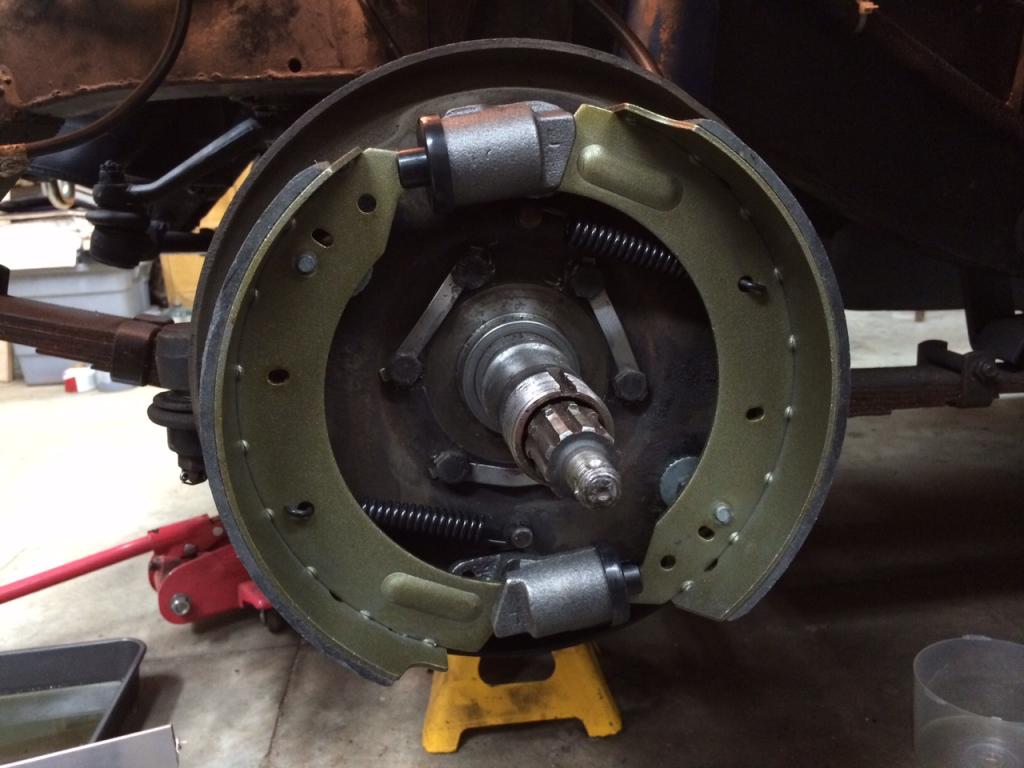

                        I found on my Series II with the CB master cylinder that despite having bench bled the MC the only way to get fluid to move into and through the system was by using pressure.
                        When bleeding if there is much air in the lines there's not enough suction developed at the MC to draw fluid through it when the pedal comes back up, the air just expands and contracts. This is true even if the bleeder screws are closed.
                        I made up my own pressure device using a portable air tank at 12 psi with a quick release air fitting snapped on to a companion fitting on a gasketed scrap of wood I clamped onto the reservoir. One does have to remember to monitor the fluid level so you don't push air into the system.
                        I have used the technique of driving the front end up a gravel banking for bleeding, trying to coax the last bubble of air out of the back of that MC. Searching for a better method I drilled and tapped a 1/4" hole on the back side of the nut at it's highest point. I filed the surface of the nut smooth and used a 1/4" bolt and copper washer for a final seal. Loosening this just a bit while there is some pressure in the system will drive out a little fluid AND the last bit of air, hooray.
                        The amount of pedal travel is of course affected by any air in the system but even with an air free system it takes a certain amount of pedal travel just to bring the shoes up to where they meet the surface of the drum.
                        Unless the shoes have very little wear and are adjusted very close to the drums much of the pedal travel is taken up simply in moving the shoes closer to the surface of the drum. When the pedal is released again to "pump" the brakes for a second time the strong set of upper return springs immediately pulls the pistons back into their bores and you're back where you started from with long pedal travel.
                        For my Series II, I removed the upper set of return springs and rely only on the lower set of springs. This allows the shoes to just barely float on the surface of the drum.
                        It also prevents the pistons in the wheel cylinder from being pushed back into their bores every time my foot comes off the pedal. I now I have a very stiff pedal with only about 2"-3" travel, first time since 1974!
                        I hope to put this on the road soon and I'm quite sure the brakes will not drag enough to heat up. If so I'll add a set of very weak springs.
