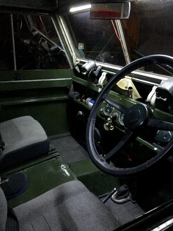

I installed a couple of LED lights just over the top of the windscreen and they are tied into the dome light switch. They are super bright and you can barely even notice the fixtures themselves.
I thought about trying to install them on the first hoop, but am glad I put them where I did now that they are actually installed.

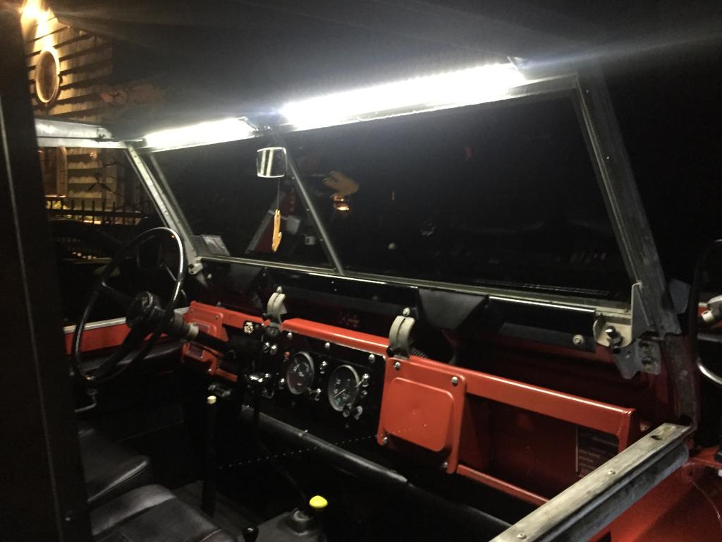

I did something similar to what Contractor had done.

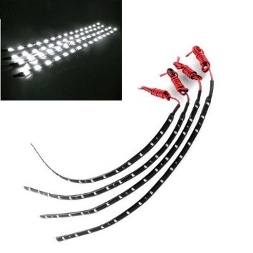

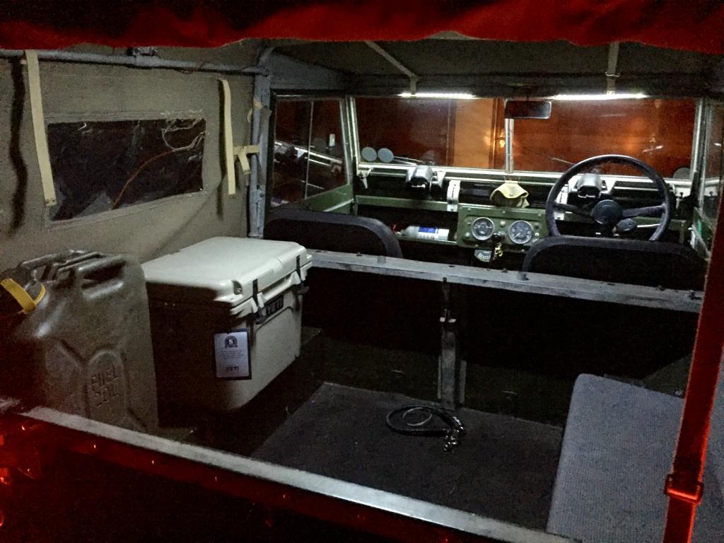

I installed three strip-LEDs last night, took about three hours total to plan the routing, run the wire, then wired 'em to a SPST toggle that's powered off the ignition. Lights can be operated either by the toggle or the ignition switch.
I used three of the four strips in the $7 pack from Amazon, two above the windscreen and one under the middle hoop over the tub. These strips fit right under the lip above the windscreen glass so they are totally recessed and hidden from view when switched off (finally got lucky for once). The wire is segmented in sections with quick clips so the hoop set can be removed without disturbing the lights up front.
What a difference!!!!
